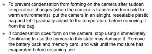

We have some advice on this quandry in the big manual that would have come with your camera. It's on page 155.
This is what it says:
You can download the manual in its entirety HERE.
