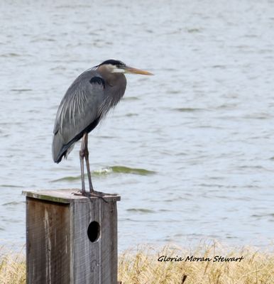

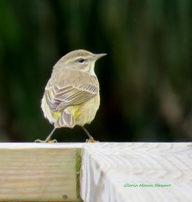

Bird photo examples that I have taken on 1/15/14.
