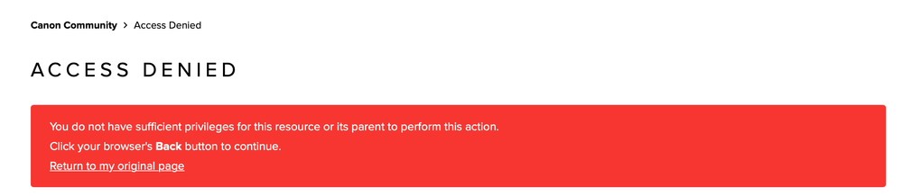

I did not find any setting in my router for assigning static addresses, other than for the router itself. I did remove and re-add both printers at IP devices with their endpoint static addresses and that seems to be working. We'll see how it goes this week.
WRT to the document you posted, I was denied access.

Thank you very much for your feedback. Can I please know the brand and model of your network equipment?  Maybe I can provide additional guidance.  No one else has said my document is inaccessible so I will check it for you again.
Try the link again and let me know.  I'll reach out to the moderators if it doesn't work for you.
https://community.usa.canon.com/t5/shadowsports-s-KB/How-To-Static-or-Reserved-IP-Assignment-For-Pri...
