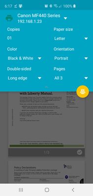

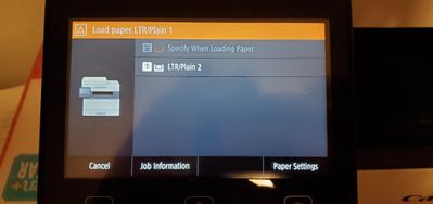

I have done that on my Samsung S10e. In the print dialog I select Letter and it still prompts me on the printer to select the only option available which is Tray 1 which is letter. Here is a screenshot of my print screen on my phone and what it produced on my printer.
It won't print until the select the only option available which is Tray 1 LTR/Plain
04-01-2020 10:51 AM - edited 04-01-2020 11:26 AM
OMG I just figured it out. It works if I change the paper weight to 18lbs even though the paper weight is 24lbs. Which is terrible because I'm pretty certain the printer is using the paper weight to alter the bonding termperate used when printing.
