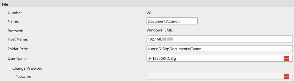

SOLUTION: I had the default software installation put on the PC. In the end after much tweaking and configuration, these settings ended up working in my Windows 11 environment:

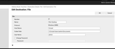

02-15-2026 05:24 PM - edited 02-15-2026 05:32 PM
That might be the issue.
Just put the hostname in the top field. See my previous image.
Mine is corsair. This is the plain text name that appears when you select Computer from the Scan menu. The path below is \\corsair\users\Documents
Or the destination of your choice
If your path, username or password is not correct, you'll get an error print from the log. Unless you change this setting, you only get a error log print If there's a failure by default.
