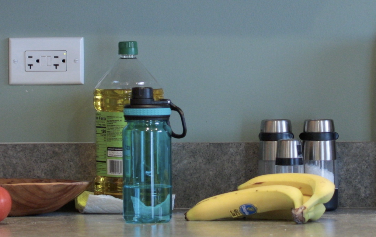

EOS 5D IV, 50mm f/1.2 L @ f/2.8, 1/50 s, ISO 800 DCI-4K, 23.976 fps

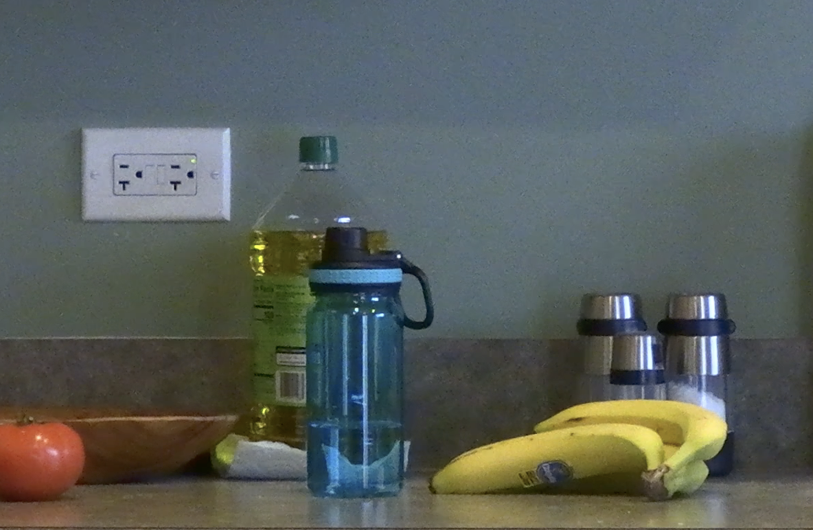

Vixia HF G50, f/2.8, 1/48 s, Gain 18 dB, UHD, 23.976 fps
Here are some crops showing 1:1 pixel sizes:
First, the 5D
Next, the G50:

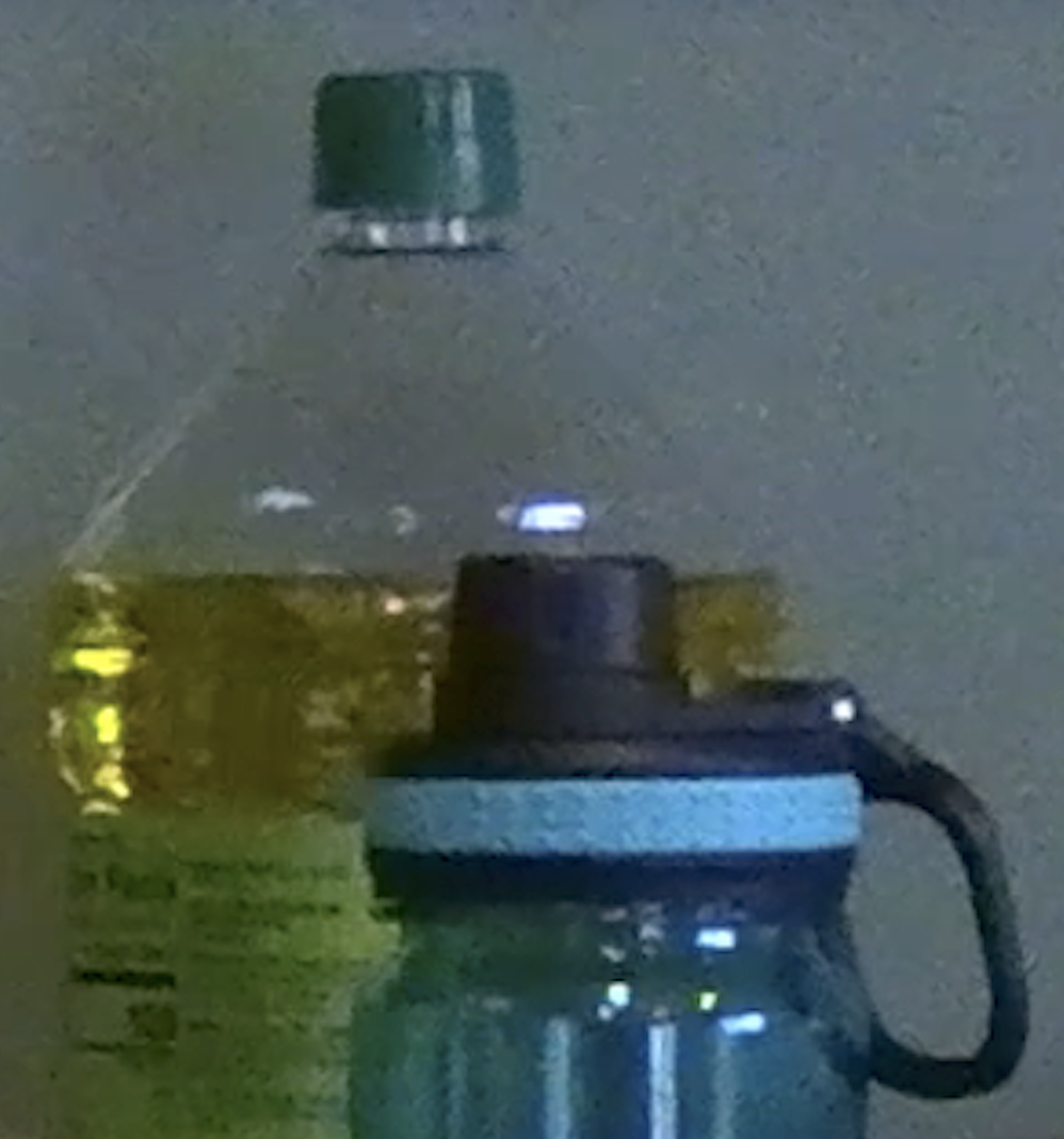

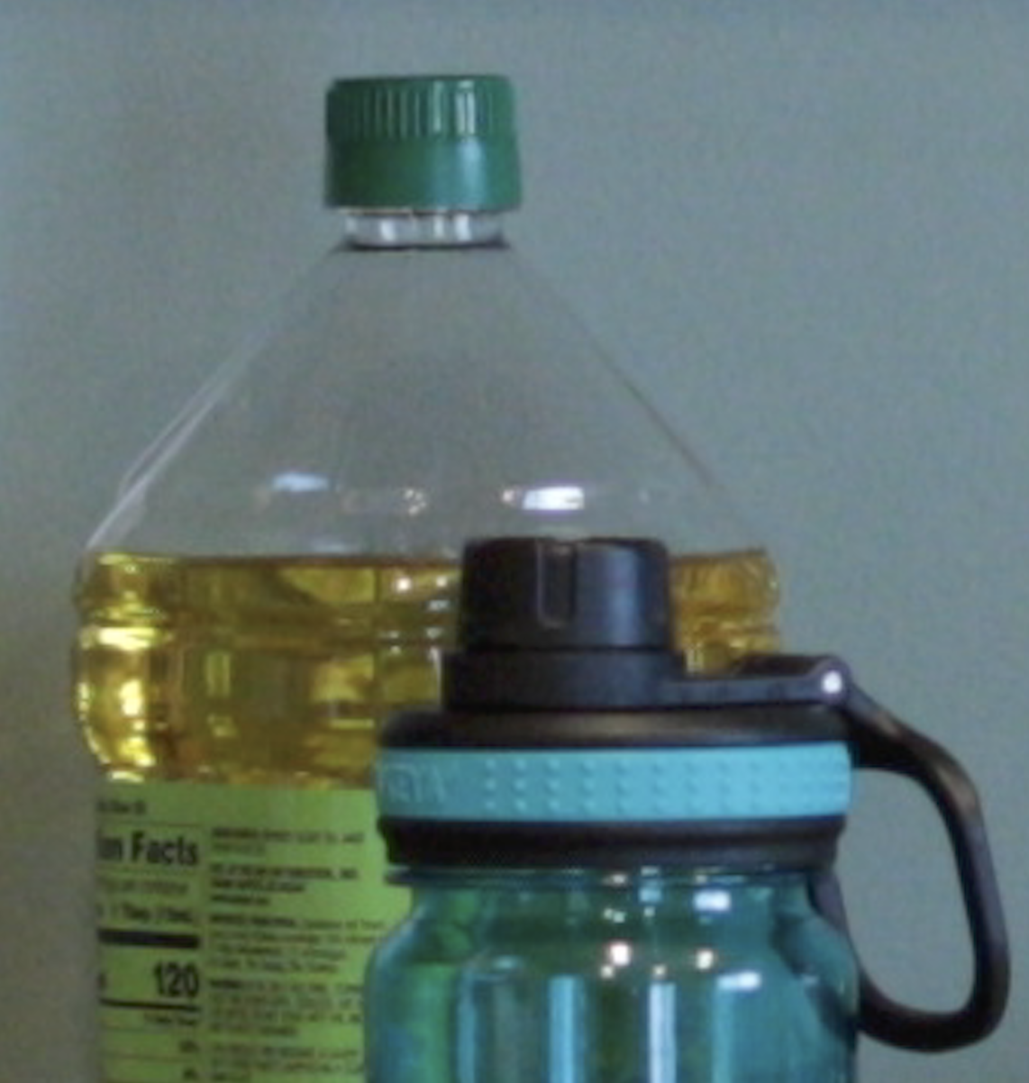

And now some magnified images. First, the 5D again:
And then the G50:
The Vixia maxes out with a Gain of 24 dB. That would then be ISO 1600. You can already see a huge amount of noise. And for dark scenes, the only way to try to compensate would be to drop the shutter speed. But if that's then below 1/24 s, the footage is rather useless.

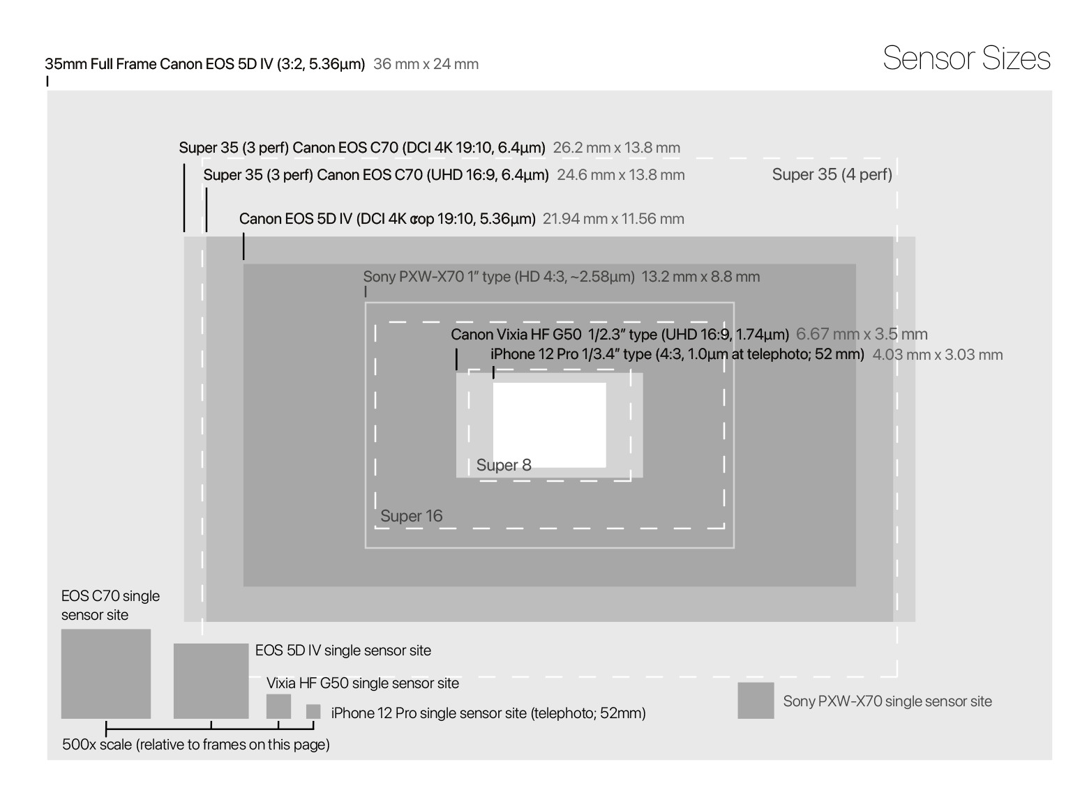

For reference, here's a graphic I made showing the various sensor sizes of various equipment along with the relative sensor site sizes.
