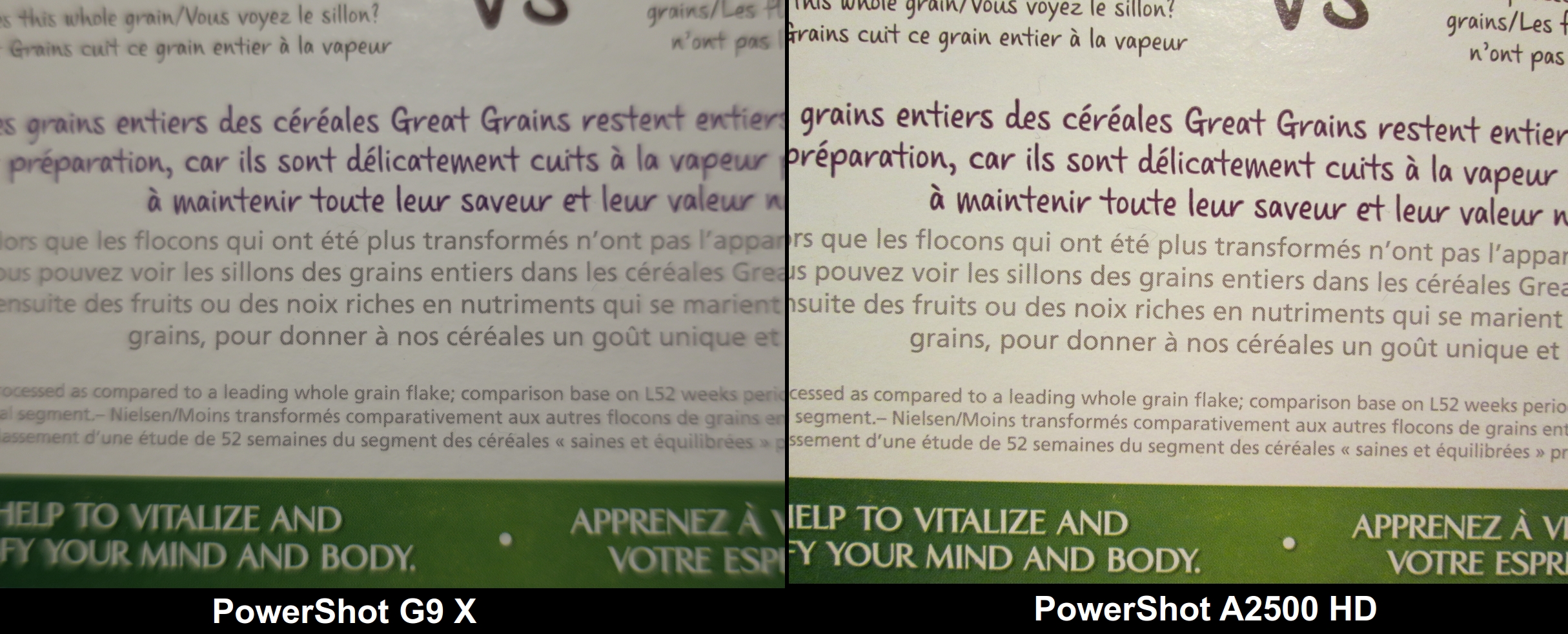

I need a camera that can take decent close-up pictures, specifically of small text on labels, or books etc.. The camera should have stabilization and good low-light imaging so I don't need to deal with flash glare. The last camera I tried (PowerShot G9 X) performed terribly by focusing only on certain parts of the shot, leaving the rest very blurry. I already started another thread about this issue, and the replies are generally saying the G9X is supposed to do that and the work-arounds are complex.
I need a simple point and shoot. My A2500 did well for macro shots, except it lacks stibilizing, and isn't so great in low light. Any suggestions? Please see the comparrison below:

Buy a good tripod with a horizontal arm, so that you can position the head over a table, and use your old camera. When you use a tripod, low light becomes a moot point. You can set the exposure for as long as you want and use ISO 100.

I do have, and use a tripod, but if Im reaching inside a computer case to photograph a part label at some difficult angle a tripod is no help.

Small cameras with small image sensors take great Macro shots. When you start getting into bigger cameras with bigger image sensors, you will need more specialized equipment and good technique to get good Macro shots.
I would suggest going back to your A2500 but using some type of "Magic Arm to position the camera where you want it.
They are available on eBay, Amazon, or your local camera store.

@AnthonyD wrote:I do have, and use a tripod, but if Im reaching inside a computer case to photograph a part label at some difficult angle a tripod is no help.
Your sample photo showed the subject laying on a flat floor. Whatever the case may be. It makes little difference.
Use an arm. It does not have to an articulating arm, but one would be an immense help. You need a fairly robust tripod when using an arm, so tha **bleep** does not tip over and smash your camera..
You may want to look at focusing rails. Check out "Dot Line Focusing Platform". What really helps is being able to tether the shot, and manually focusing the lens.
