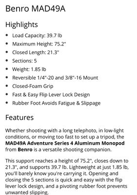

You want a monopod that’s at least as tall as you are. This makes angling the camera skyward easier. I use a Benro alloy 75-inch monopod. I am tall. The weight savings with carbon fiber are small. The savings are insignificant once you factor in the weight of the gear. Not fully extending the sections increases strength.

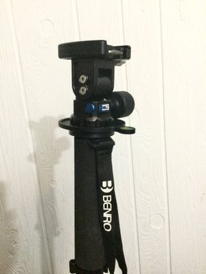

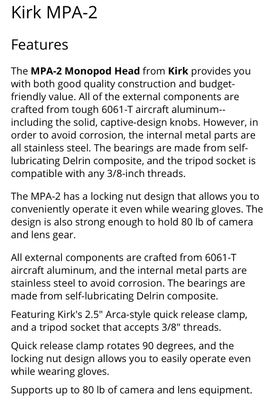

I use a Kirk tilt head, MPA-2. This head has excellent strength and friction control. You can partly tighten it down and not worry about gear flopping around. Having the tilt head makes it MUCH easier to change your aim from horizontal to near vertical. No leaning or moving your feet.
This is my rig.

Note the weight capacity of the monopod head. It’s 80 pounds. With a 1Dx Series and a 400mm f/2.8, yes you will need and appreciate something that strong. It takes several full rotations of the control knob to go from fully open to fully locked down.
I am on the road, so I can’t pull it out and check it. I wast to say 4-5 full rotations. Most heads have locking knob that needs about a full rotation range of motion. The Kirk head has a full blown friction control. Highly recommended! 10 out of 10.
Be wary of monopods that have three small legs or feet. The are to stand erect and stable until you mount your gear. Now it turns into a balancing act. The rig is terribly top heavy.
