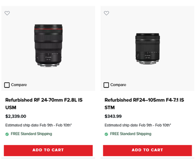

As of this writing both RF lenses in that focal length range are available refurbished.  For my skill and use level it isn't worth the very nearly $2,000 difference in price.  I would think that's especially true on an IBIS APS-C camera, but even for my R6 Mark II it isn't for me.  YMMV
