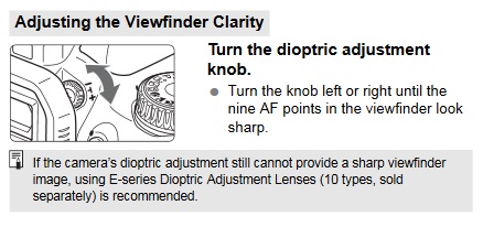

Did you change the diopter adjustment on the viewfinder?

02-09-2020 12:20 PM
i have tried this and it does not help

If the diopter wheel doesn't fix it or perhaps it is broken I doubt you are going to fix it yourself. One thing, however, if you wear eye glasses you might try it without them. Try both ways. You could just be out of adjustment range with glasses on.
