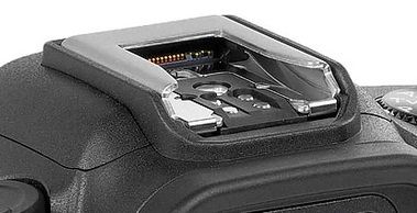

02-13-2026 09:30 PM
As you can see from this image:
The R8 has both the new-fangled fingers *and* the 5 pin traditional contacts, so older flashes work fine.
