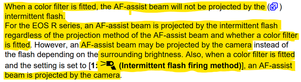

05-24-2023 05:04 PM - edited 05-24-2023 08:04 PM
Only the R6 Mark II has the multi interface hot shoe. The original R6 doesn't have that hot shoe. The IR AF Assist Beam from a speedlite is INCOMPATIBLE with ALL mirrorless camera systems and is DISABLED. When a Canon speedlite is used Intermittent Flash Firing (Disco Flash) is used instead of IR. Even with a speedlite with a Personal Function to switch between IR & Intermittent Flash Firing (Disco Flash). Intermittent Flash Firing takes precedence on R series cameras. The only thing that setting does on an R series camera is. When a color filter or a flash diffuser attached. The camera will emit an AF Assist Beam instead. Since Intermittent Flash Firing doesn't work with a flash diffuser or color filter. But this is dependent on the ambient lighting.
IR AF Assist IS NOT possible on the EOS R Series. Intermittent Flash Firing is used instead. Even for speedlites without a Personal Function for Intermittent Flash Firing. The picture above is an example of a speedlite that has both options for AF Assist.
