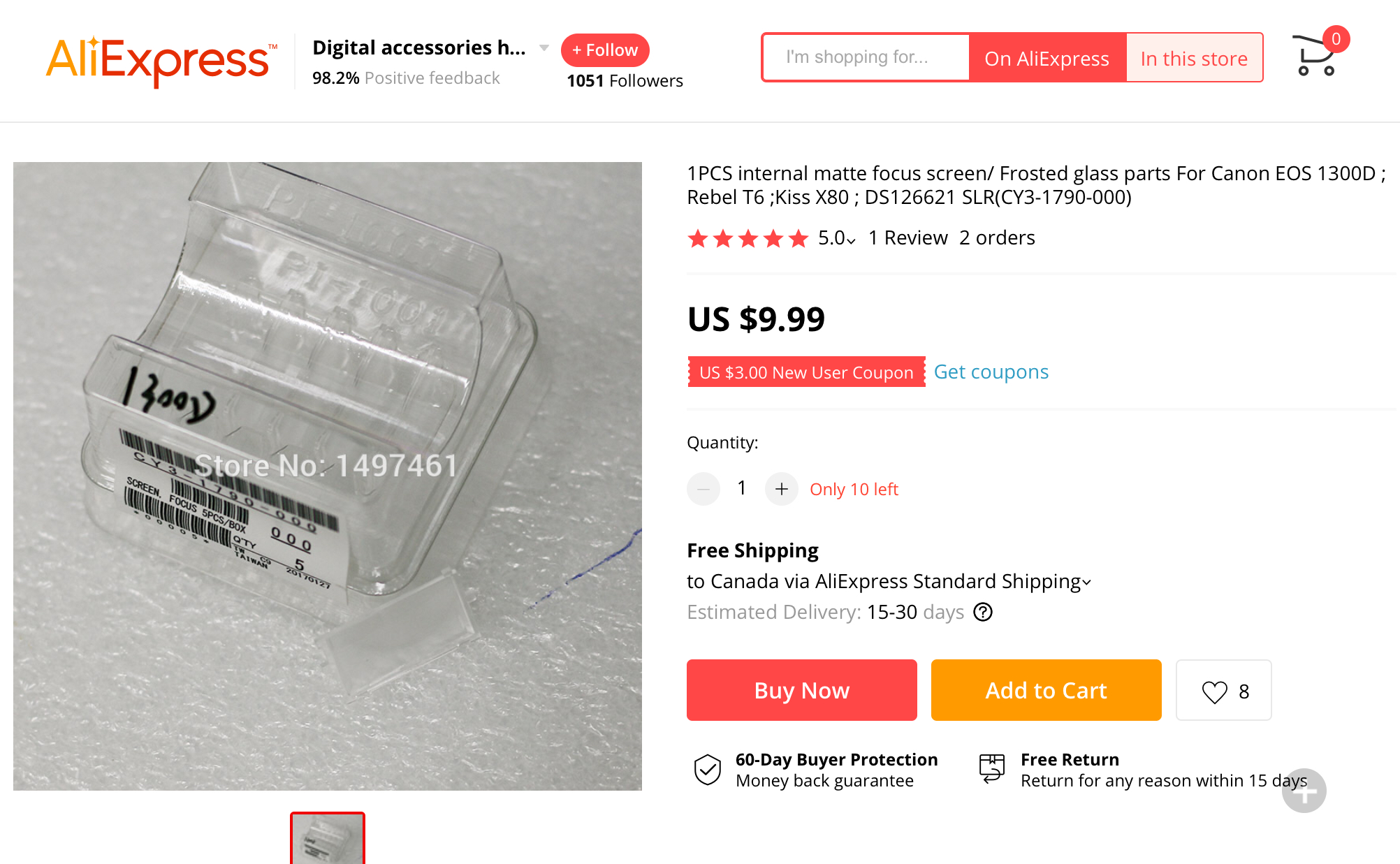

There seems to be a lot of sellers online claiming Canon part number  CY3-1790-000 is the focus screen for the T6 1300D.
If that is true you should be able to have a camera repair shop change it for you.

There is not a "user" replaceable screen, but I just called Canon and they do sell a CY3-1790-000 focus screen for the T6.
If they sell the part then it must be replaceable by a qualified service technician.

Canon doesn't do the replacing and our best local shop won't do it, and says the people they outsource bigger jobs to won't do it.  That said. The video is pretty self explanatory...
1) Wear surgical gloves
2) turn the camera upside down
3) use tweezers to push the little metal clip in front in and upward and remove the top metal frame that holds the focus screen in place
4) use tweezers to remove the old screen
5) takeout the bottom metal frame below the screen
6) use a brush and air bulb to clean out the camera
7) put the bottom frame back in
😎 place the new focus screen in place
9) put the top metal frame back in, making sure to place the two little tabs in the back into the little holes in the camera
10) push down and lock in place
Pretty much the same way it works for the all the higher D series cameras with the user removable/cleanable/replaceable focus screens.  But, because the Rebel series is considered disposable tech, much of it is considered to be unserviceable, even if it can be serviced.
