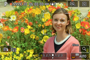

The AF has found the face within the large bounding rectangle. This large box can change shape and size as needed.
Within the box there’s an AF point that has locked focus on the eye. Conventional Evaluative Metering mode would use the eye area to bias the exposure. It seems like Priority AE uses a larger area, possibly the bounding rectangle.
