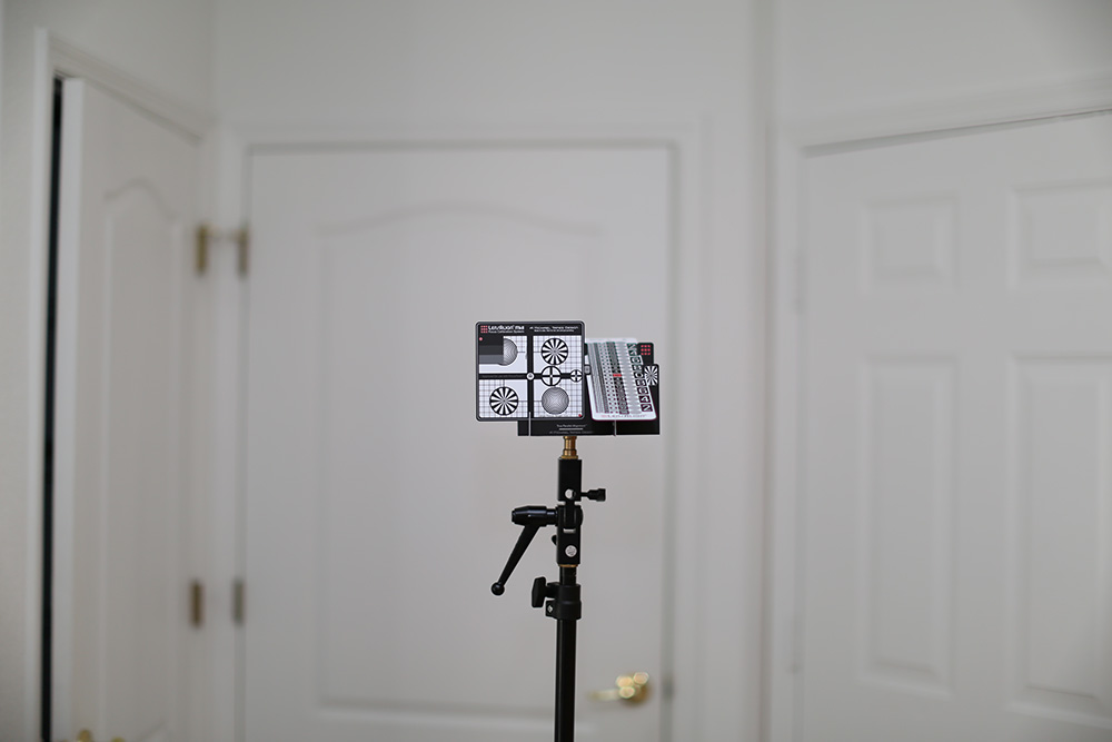

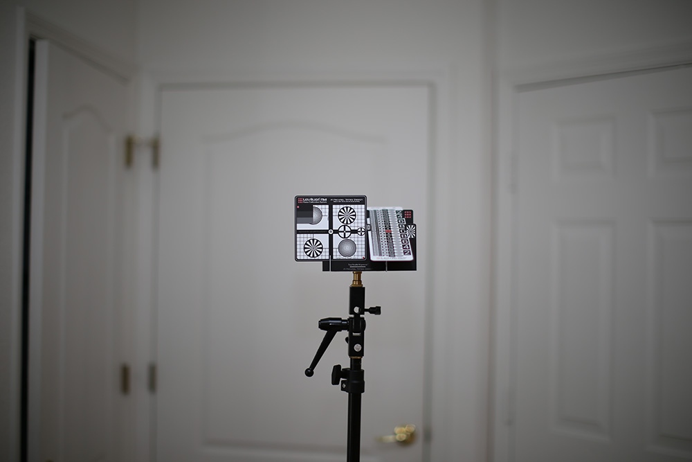

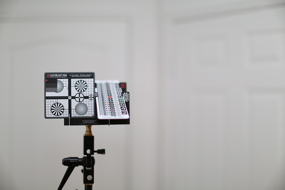

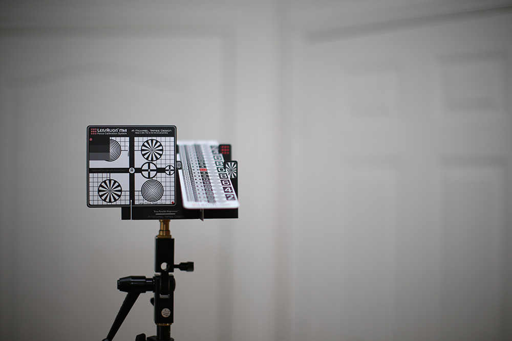

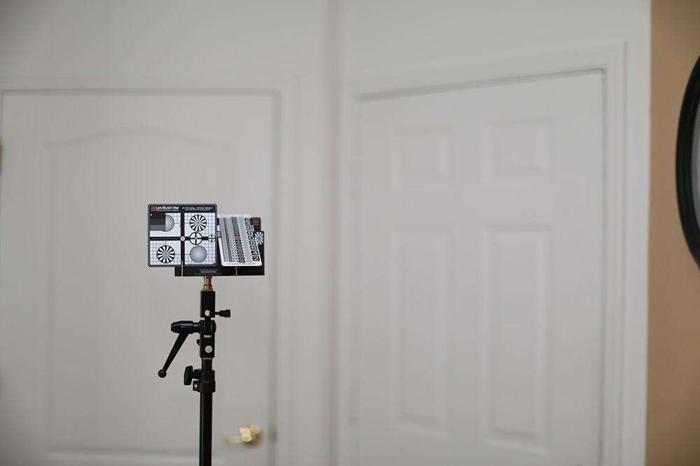

Hey guys I just switched from Sony to Canon in the last couple weeks and have had quite a few focus issues with the 5DIII I have a FocusAlign and also FocusTune software and have calibrated all my lenses to spot on. I have - 50 1.2, 85 1.8, 50 1.8, Sigma 35 1.4, tamron 70-200VC and a Tamron 90mm... So EVERY single lens has a focus adjust dialed in on both the 5DIII 6D and 7D. That isn't that bad but I figured it would be better buying all new gear. All my Sony lenses also had a focus adjustment though so that's ok. But here is the main problem - after our first wedding (where I told my wife who shoots the new 5D, to trust her focus points now), the 50L front focused on every shot where she didn't use the center point. And that was just about every portrait! So this is not good at all. So I put it back on the tripod and shot the lensalign a bit more and found that it has really bad front focus on every point but the center. The farther back the subject is, the worse the front focus is. So after a bit of research, I found that this is somewhat normal due to the curvature of the lens and the design of the optics in general for being a 1.2 lens. BUT here is the crazy thing - it focuses almost perfectly on the 6D! With any focus point!
So I called CPS and they said that I could send it in to be calibrated but I asked why it would focus perfectly on the 6D and not the 5D. They were mostly clueless but said to try to just use the center point! That isn't that bad and we can live with that, but why would it work on the 6D with a far less quality focus system? I tested all our other lenses on the 5D and it looks like the outer points work great with every other lens - including the Sigma 35.
I ordered another 50L that should be here tomorrow to really nail down if it is then lens or the body but I wanted to get some feedback to see what you guys think! You guys out there with the 5DIII and 50L, can you use the outer points at all? I have it set to just cross type points, single shot, manual point selection. Then I also tested the midway cross type points and they also front focus. But as far as the 6D to the 5D - the outer cross type points are in the same place in terms of how far out they are into the edge of the glass. So it's not like the 50L would have a harder time on the 5D than the 6D Would you guys point more towards the lens being bad or the body having issues? I can't narrow it down well since all the other lenses work fine with the 5D and the 50L works fine on the 6D! I'm going crazy! And we have 11 shoots in the next 5 weeks so there is no way I can send the body or lens in for repair!

I'll attach a few pics from just now so maybe that will help. I can also upload a few from this last wedding - as they are much more pronounced.
