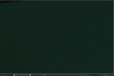

I would say that the pixel mapping feature via Clean now is for hot pixels visible at short shutter speed. You hear the shutter closing and opening. It is not for dark current build-up.
Another thing you can test is high ISO. My 6D and M5 try to remove pixels automatically at ISO 6400 and above. R6 at ISO 12800 and above.
Sample raw files from 6D with configuration files for darktable https://kameratrollet.se/wp-content/uploads/2022/11/hot-pixels-ISO6400vsISO3200.zip
darktable, RawTherapee, dcraw and LibRaw are able to show you the Bayer pattern before demosaicing, just like the screenshots above.
