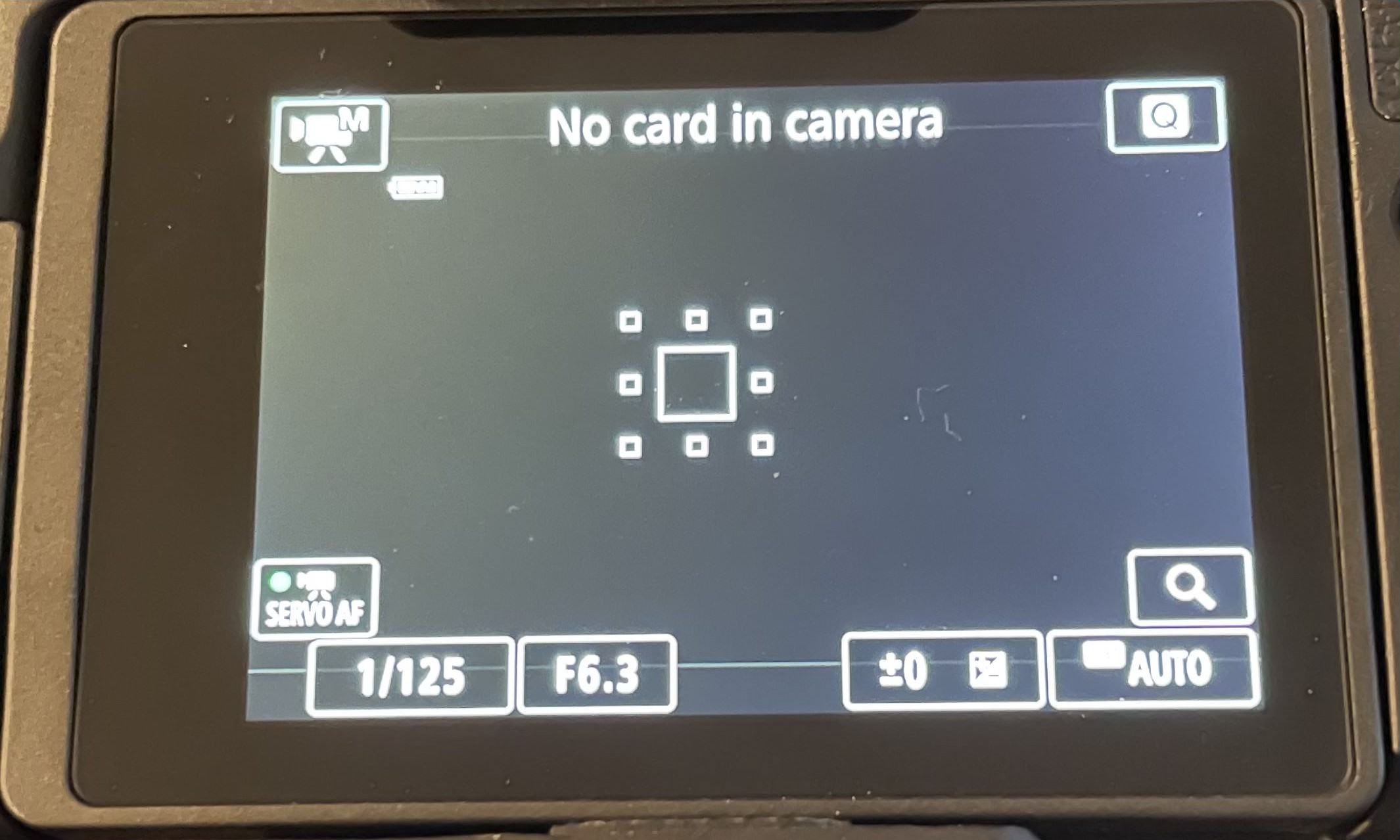

I just started using a professional camera like this, I've had no prior experience and the main purpose of the camera is to record cooking videos. I've watched a few YouYube tutorials for beginners and have the video settings to this on the main page. Yesterday when I was recording I noticed that the brightness was shifting when a white bowl was placed on the dark cutting board. It looked like it was trying to adjust between the dark brown cutting board with the white bowl. Is there a way to stop the brightness from changing when shooting a video?

You're going to want to be in full manual. It appears you have ISO set to auto.
A DSLR or mirrorless camera (for photos and video) will attempt to adjust exposure for the scene so that it will end up being middle gray. If the scene is mostly dark, the camera will adjust exposure to compensate. When the scene is mostly light, the camera will then adjust exposure to compensate.

What is the ideal ISO setting you would recommend? I tried setting it to 100 but I couldn't see anything through the lens, it was very dark. At 6400 was finally matching the brightness on the auto. Also, it was in a dark room with two softboxes.

Looking at your settings I believe there's more than one thing that's causing the automatic change or brightness. It could be the AUTO LIGHTING OPTIMIZER; You may need to disable it. I would also set my ISO to 100 and then use the SHUTTER SPEED to brighten the image. If the image is still too dark then you'd have no choice but to start increasing your ISO (just try not to go too far because the image will become grainy and look less professional which is more noticeable when you zoom in or view on big tv's). If you do have to increase the ISO then most new cameras have an ISO NR (Noise Reduction) mode that can kind of help with this but I still like to keep my ISO as low as possible to be on the safe side. *It's very important to film in brightly lit areas...so bringing lighting directly to the image you are capturing will make the camera have to do less work. The more light directly on what you're capturing the better the image. Use direct light on whatever you're capturing rather than just a light in the ceiling. Even a cheap ring light or two directly on your image is better than using the light from the ceiling. Your ISO, Exposure and Auto Lighting Optimizer are likely the main things that are changing the brightness. Once you fix those you should be all set. If not You also have a METERING MODE. I know it all sounds confusing but once you read your manual on these settings you'll be able to fix auto settings when they get confused in no time. Auto settings are okay for a beginner but sometimes the camera may think you want it to do something else. Your Auto Focus settings can also play a part in what it's focusing on that could be triggering the camera to focus on the incorrect thing. Based on the 8 dots around the Auto Focus square I can see that you have the camera set to Expand AF area: Around. Read your manua to understand the different AF modes. The AF Mode you are in could be causing your camera to put focus on the wrong thing when you are shooting. I have never used Expand AF area: Around but it depends on what you are filming. Your camera is really smart but it still needs to know what you want it to do. I typically use Face + Tracking Mode because I'm normally filming my face and want the focus to track my face and not the objects behind me. If you are only filming objects on a counter for cooking you may want to try one of the ZONE AF MODES. I BET THIS WILL HELP YOUR CAMERA TO STOP CHANGING FOCUS WHEN YOU MOVE AN ITEM

If that doesn't work, there's a star * on your camera that can lock exposure. You may want to lock your exposure if it keeps changing even when the ISO is locked.
1.) Diable AUTO LIGHTING OPTIMIZER
2.) ISO (Set your ISO to 100 [or as low as possible] and then use shutter speed to brighten. [The shutter speed is the one you have set to 1/125]).
3.) METERING MODE (Determines where the camera looks to adjust to the average light it sees. Your manual is your best friend. If you don't have one you can download a digital version free from Canon. Set to your liking based on the result you're trying to achieve.) I SHOULD HAVE PUT THIS ONE LAST BECAUSE IT'S PROBABLY THE LEAST OF WHAT'S CAUSING YOUR PROBLEM BUT DOES HAVE TO DO WITH LIGHTING
4.) Choose an "AF ZONE" MODE instead of "Expand AF Area: AROUND"
5.) EXPOSURE LOCK * (The star * on your camera can lock the exposure so it doesn't move)
6.) SHUTTER SPEED (You currently have yours at 1/125. Once you move your ISO to a lower setting you can use your shutter speed to brighten the image. This will make things move slower or blurry if items are moving really fast, but for cooking this will likely not be noticeable. You would notice it more on something like if someone was running really fast or moving their hands really fast. casual cooking video isn't going to move so quickly...but if you feel the need to change it then you'd have to bump up the ISO so that you can get the shutter the way you want.)
7.) Set your ISO NR (Noise Reduction) to compensate for the noise (grains or small random dots or grit in the image) from higher ISO's. You can still use ISO NR even if you use a low ISO like 100.
The order doesn't matter I'm just trying to make it easier to read from my first comment.
