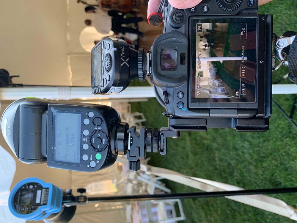

I have transitioned from Canon DSLRs to Mirrorless 3 years ago. While shooting events with my 5D3 or 5D4 I used a flash bracket TTL cord to avoid shadows and red-eyes. I hardly put the 580EXs directly on the camera hot shoes.
Nevertheless, when I'm selling all my DSLRs, I had to send in one of my 5D3s for loose hot shoe repair (with CPS membership it still cost over $300) before I could sell it.
When I switched to mirrorless cameras (R3, R5, R6) I have also started mostly off camera flash photography. From the lesson I have learnt, I have modified brackets for each camera so I can sit the flash lights on the brackets and use much lighter remote triggers to trigger the "on bracket flash" and other off camera strobes.
A year and half ago my R6 became unreliable in triggering flash lights (all NOT on hot shoe) and I had no choice but to ship it for repair ($300+). This is a failure of the hot shoe with 0 on-camera-flash photography.
And just over the weekend, my R5 hot shoe stopped triggering other flash lights.
For 2 years plus I have been telling all fellow photographers to stop putting flash lights directly on hot shoes, but even with such precaution, the hot shoes still failed.
I have been extremely happy with the operation, the focusing ability, the color science of my Canon cameras, but this hot shoe issue is one thing that's driving me crazy. I don't know when my R3 will have the same problem.
I understand the stress on the hot shoe when anything significant is on it, and I believe this applies to any brand name, but I really think this should not have happened on a $3,800 camera especially when only very light remote triggers have been used on it.

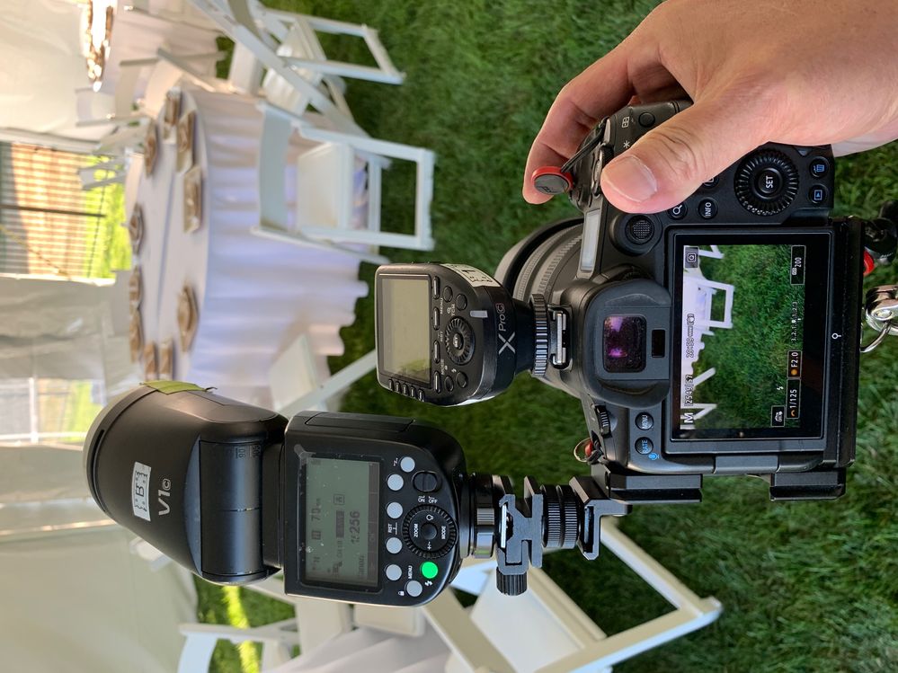

May I ask what brand is your bracket? I like the design of it, I will have to start doing this to not put stress on my hotshoe. Mine is currently getting repaired
09-18-2024 07:14 PM
The brackets for both R3 and R5 (R6 is the same) are both Smallrig, I think around $99 and $30 at B&H and on eBay. You need to buy some 1/4" adaptors and cold shoe to put together yourself. Look at the top photo I posted and pay attention to where the flash sits on the cold shoe, be sure to get the cold shoe with a recess on the bottom so when the flash is on it, the contacts on the flash foot do not touch the metal to short the flash.
09-18-2024 07:16 PM
Those adaptors you can find at B&H or Amazon, you also need those blue thread locks so the adaptors don't become loose during a shoot.
