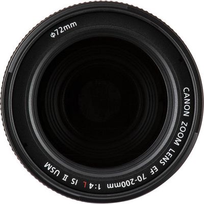

Which version of the EF 24-70mm exactly. There are multiple versions of that lens. So saying “EF 24-70mm isn’t good enough or a complete name. Remove the lens cap and the name can be found on the outer ring. I have example lenses below to help you identify your exact lens model. Without knowing the exact lens model we cannot help you. All we know is the lens focal length and that it is an EF lens. But we don’t know anything else about it.
-Demetrius
