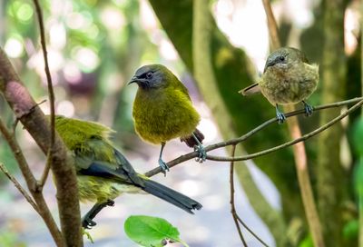

The following two are taken in conditions similar to your example. Again spot focus allowed me to choose the eye of my selected subjects - in the case of the second image, the middle bird.
247mm, f/5, 1/125sec, ISO-3200247mm, f/5, 1/125sec, ISO-3200   277mm, f/5, 1/125ec, ISO-6400277mm, f/5, 1/125ec, ISO-6400
cheers, TREVOR
