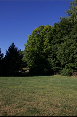

Go outside on a sunny day. Set the camera in manual mode to f/16, the iso to 100 and the shutter to 1/100 second.
Is the shot properly exposed?

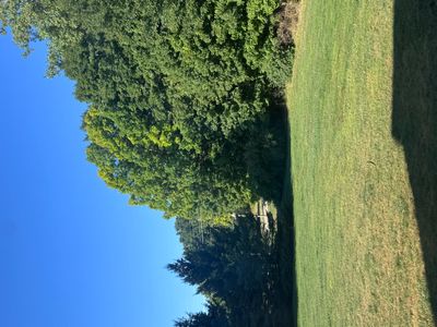

went outside and took the pictures to your advice. Top image is from my camera. Second is from my phone to show how sunny the day is for reference.

That shot is obviously a lot darker. Do you have another lens to try? I can only think that the aperture is off somehow.
