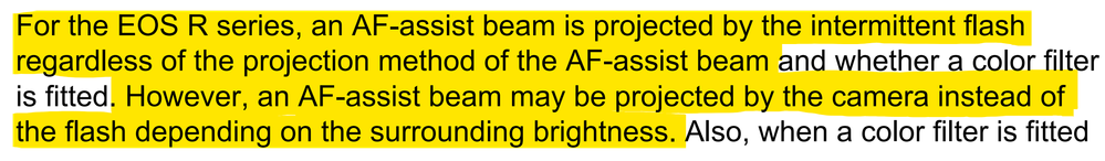

@SignifDigits there's also another time the speedlite can produce what looks like a pre-flash. This is called an "AF Assist Beam". Under difficult lighting with the camera set to One Shot AF the speedlite will switch to Intermittent Flash Firing Mode to provide an AF Assist Beam. All of Canon's own speedlites all the way back to the very first E-TTL compatible speedlite will provide an AF Assist Beam this way on EOS R series cameras (EXCEPT the EOS R100). Note depending on the AMBIENT LIGHTING an LED AF Assist Beam maybe projected by CAMERA instead of Intermittent Flash Firing from the speedlite. The EL-5's LED AF Assist Beam works differently when used on the EOS R3, EOS R7 & EOS R10. On these cameras the LED AF Assist Beam is projected at FULL BRIGHTNESS ONLY. If the ambient is too low the speedlite will switch to Intermittent Flash Firing or the camera body will emit an LED AF Assist Beam. On other multi function hot shoe cameras such as the EOS R5 Mark II the camera can adjust the brightness of the LED AF Assist Beam depending on the Ambient Lighting. The speedlite will NOT switch to Intermittent Flash Firing. If the speedlite overheats the LED AF Assist Beam automatically reduces brightness or switches to Intermittent Flash Firing for SAFETY. In this case the camera can also project an LED AF Assist Beam.
EOS R Series AF Assist Beam Protocol 2.pngEOS R Series AF Assist Beam Protocol 2.png
EOS R AF Assist Beam Emission Method.pngEOS R AF Assist Beam Emission Method.png
