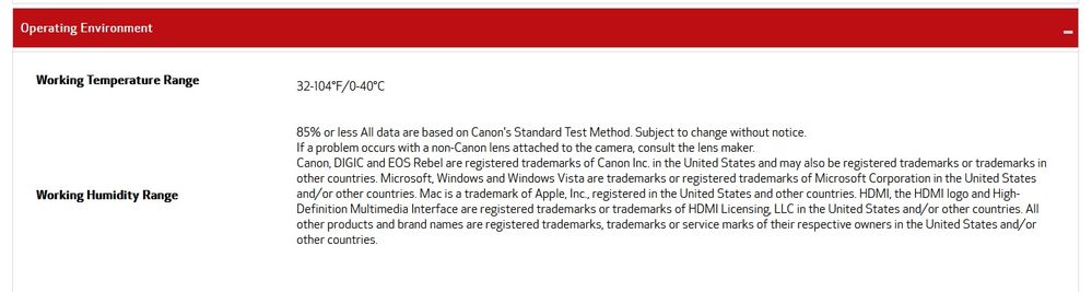

I suspect that the issue is not the actual temperature per se, but the humidity. Scratch what's in the brackets! (Is the 85% or less supposed to be humidity? - It does not appear to be clear in this screen shot.) I just rejigged my display and the rest of the shot came clear! Sorry about that Kevin!!! Then certainly. that is likely to have been exceeded if the description from the OP is accurate.

Yeah, the humidity spec is messed up. Ignore everything after the "or less", the rest is specification boilerplate. Can you fix that Canon?
