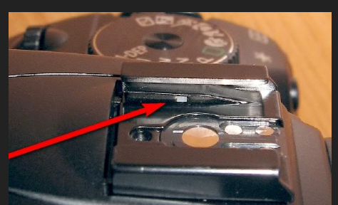

Are you seeing no flash at all when you trip the shutter? Do you have anything mounted in the hot shoe that would fool the camera into thinking there's an external flash attached? Is the little switch in the one side of the hot shoe sticking in the down position?

I'm home from work and tried taking a 10 sec timer photo on automatic setting. The flash did not go off! Where do I go from here?
