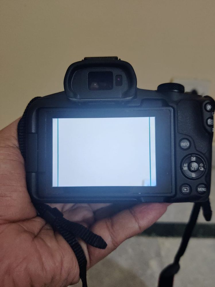

I am using canon eos r50, when I click a picture in RAW mode and look at the image I saw two blue line on both the end (Please have a look on the attached images). either I click horizontally or vertically.
When I click the same on AUTO mode, I don't get blue lines.
how to get rid of this blue line in RAW mode, I am new to this camera. WhatsApp Image 2023-06-14 at 4.58.08 PM.jpeg

They are crop lines. You probably have it set to display1:1. You can have crop lines or masked. Look at you "info shooting area."

hello, thanks for the reply
it was set to 4:3, when I changed it to 3:2 , 1:1 or 16:9 it went away.
thanks
06-15-2023 06:20 AM
Greetings,
Set to 3:2. This is best.
