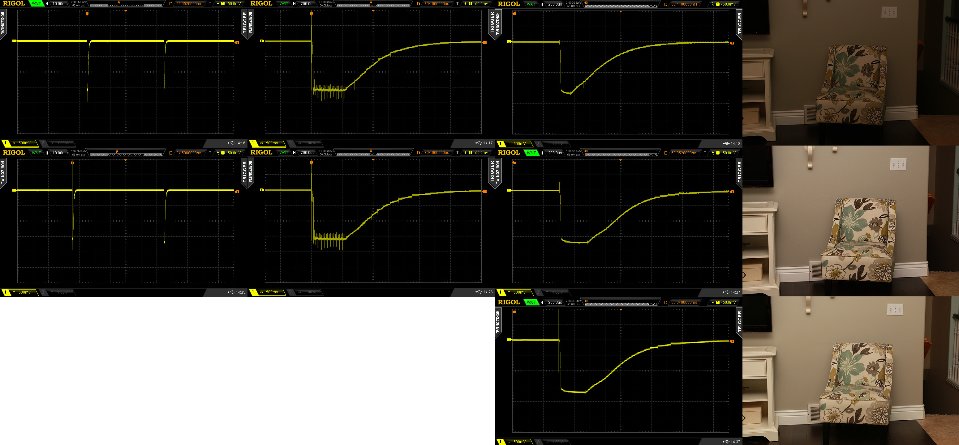

In two of those threads I've posted some results of testing I did measuring the flash output with a light sensor and oscilloscope.  I believe those results are fairly conclusive that there is a defect/bug with the 70D.
I'll repost my results from that testing here for anyone interested...
Test setup:
  • Used tripod in fixed location
  • Results taken from 70D and Xsi
  • In all cases, only the body was swapped out. Used same lens/flash between camera bodies
  • All shots taken in Manual mode, 1/100 shutter, f5.6, iso-800
  • I did not touch ANY settings during the whole shoot (except for FEC on the 70D on one shot per focal length...see more explanation below)
  • I enabled an option on my scope to capture at 56Mpts memory depth. With this increased depth, I was able to capture enough data in a single capture to show both the pre-flash and also the real flash and still be able to zoom into each flash event with enough fidelity left to show an accurate measurement.
Attached image explanation:
  • For the three attached images, there are three rows each.
  • Top row is 70D, second row is Xsi, third row is 70D...same config but I took multiple shots adjusting the FEC until the flash output was nearly identical to the flash output from the Xsi.
  • First column is a scope capture showing the pre-flash, followed by the real flash.
  • Second column is still from the same capture of both flashes in column 1, but zoomed into the pre-flash
  • Third column is still from the same capture of both flashes in column 1, but zoomed into the 'real' exposing flash
  • Fourth column is the picture correlating to the scope data captured.
Conclusions so far:
  • There is almost NO DOUBT a defect/bug with at least some 70D's.
  • I don't believe there is any timing problems...the under-exposure simply is from the camera telling the flash to output a lower level than it should.
  • The 50mm data from the 18-135mm vs from the 50mm f1.8 is VERY interesting. With all settings identical and just swapping the lens...exposure between the two lenses should be nearly identical. This right here is one of the reasons I think we can confidently claim that this problem is NOT user error, nor claim the camera is doing what its supposed to and trying to save highlights. The camera is clearly NOT doing what it should be doing when the 18-135mm lens (or other slower max aperture lenses are attached).
  • The problem is definitely related to max aperture. I really want to test a non-canon slow lens to see if it does the same thing or if its only applicable to canon lenses.
  • Pre-flash output looks normal for both cameras.
  • In the first attached image (18-135mm lens @ 135mm), I had to dial in +2-1/3 FEC on the 70D in the third row to match the flash output of the Xsi (resulting in nearly identical exposure).
  • In the second attached image (18-135mm lens @ 50mm), I had to dial in +2.0 FEC on the 70D in the third row to match the flash output of the Xsi (resulting in nearly identical exposure).
  • In the third attached image (50mm f1.8 lens @ 50mm), I had to dial in +0.0 FEC on the 70D in the third row to match the flash output of the Xsi (resulting in nearly identical exposure).
Images are fairly large to show all columns/rows/data. I've included links in the summary below so you can download the original size pictures. You probably want to view original size to see all details accurately.
Please let me know if anyone can think of additional testing I can do with a scope to further define the parameters of this defect/bug...
Attached file summary (also links to full resolution pics):
  1. 18-135mm lens, @135mm, +2-1/3 FEC needed on 70D in third row to match Xsi
  2. 18-135mm lens, @50mm, +2.0 FEC needed on 70D in third row to match Xsi
  3. 50mm f1.8 lens, @50mm, +0.0 FEC needed on 70D in third row to match Xsi
Picture #1
Picture #2
Picture #3
