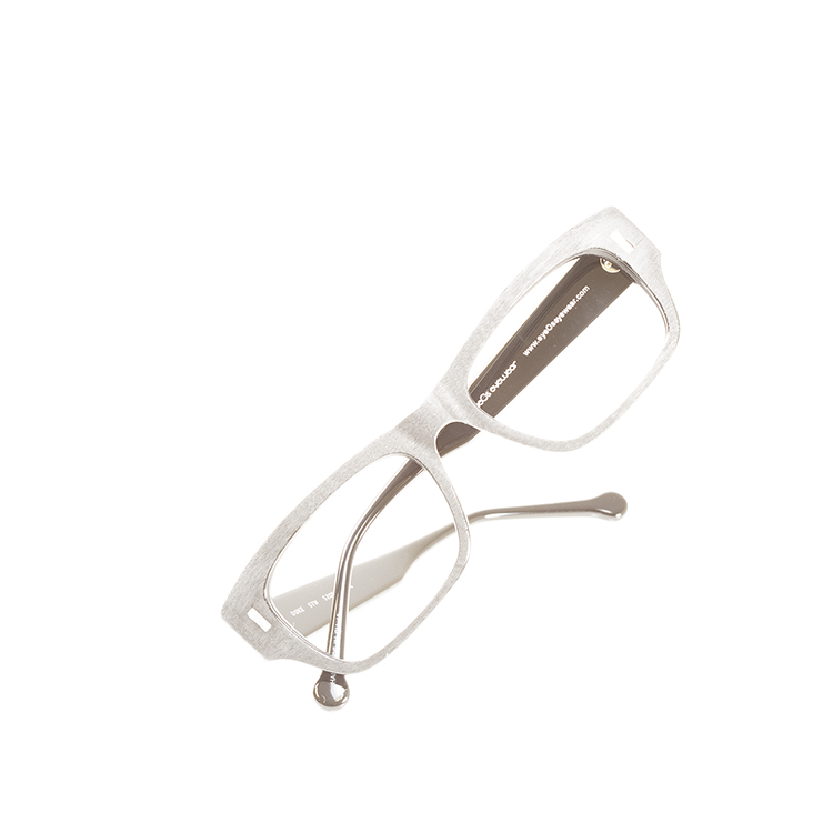

I'm shooting product and taking several shots with same settings with the following: Canon EOS 5D Mark IV Lens EF100mm f/2.8 Macro USM Setting f32 / 1.6 ISO 100 without making any changes or any adjustments to lighting or settings, every 3rd or 4th shot i get an overexposed image. below is 2 examples that i just shot for this post

You can try that but it will not help. Your problem is not light flicker.  You have a correct exposure and then you have an over exposure, by several stops.  If light flicker is happening the light flickers off, not brighter.  Which is what you would need to get an over exposure. A two second SS will see the same amount of flickers anyway!
Since you are shooting at f32, I will bet the lens is not closing all the way down to f32 on the over exposure. This could be due to a faulty lens and is almost the only way your problem can happen.

Since these aren't individual images with EXIF data, I can't inspect camera settings or what the camera did.
Tell me more about mode & settings used.

i wasn't using a flash. Here's a list of the equipment and settings:
Lighting setting exact for
GVM Dimmable Bi-color LED Video Panel Light set at 6000
These photos have all the properties
It has nothing to do with light flicker. Smiley Frustrated  Lights don't "flicker" brighter. If they flicker, they flicker off!  Call Canon 1 (800) 652-2666

The flicker answer was and is silly.  Smiley Very Happy  You are getting an overexposure because you are getting more light. Not less light. That is where you need to concentrate your efforts.
