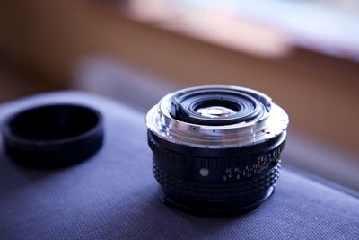

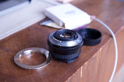

So here are some photos of the adapter, lens, and a "partial" image that I shot with it (it is a stack of books, and you can just see the top of the stack). The adapter does not have contacts on it, and looking at a few of the others on eBay, that is something that might be a problem. Also the tab on the inside of the lens could be restricting something. Could this be removed?
Error message on the screen is "Shooting is not possible due to an error. Please turn the camera off and re-install the battery"
Which I did and took another photo just fine with my regular lens. Awesome cosplay photos too!

Going by your image, it appears that the mirror is hitting the back of the lens (probably the aperture lever) and you photographed the backside of the mirror as it was moving up. Although most older manual focus Pentax lenses (along with other manufactures) can be used with Canon crop bodies without issues, the full frame bodies, with their larger mirrors, can present a problem with some lenses.
Here is a lens compatibility chart for the older 5D, but it is probable the same or close with the mark III also.
http://www.panoramaplanet.de/comp/
If you really want to use this lens on your body, the aperture lever could be cut or ground down so that it clears clear the 5D mirror, or you could shave your camera's mirror.
