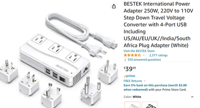

Greetings,
While your MAC and Canon battery chargers are dual voltage, I would still recommend a small converter in addition to the plug adapters. The adapters usually work, but if they don't this will, and its only $40. Its really small too.
I've used this in Russia, France and the Netherlands. Your Mac and batteries will charge and run normally. Battery Grip. I suggest Canon BG-E20. Vello and Neewer also make grips, but I've read they either work great or don't, thus I can't give them a thumbs up. Watson batteries get a 👍 from me.
