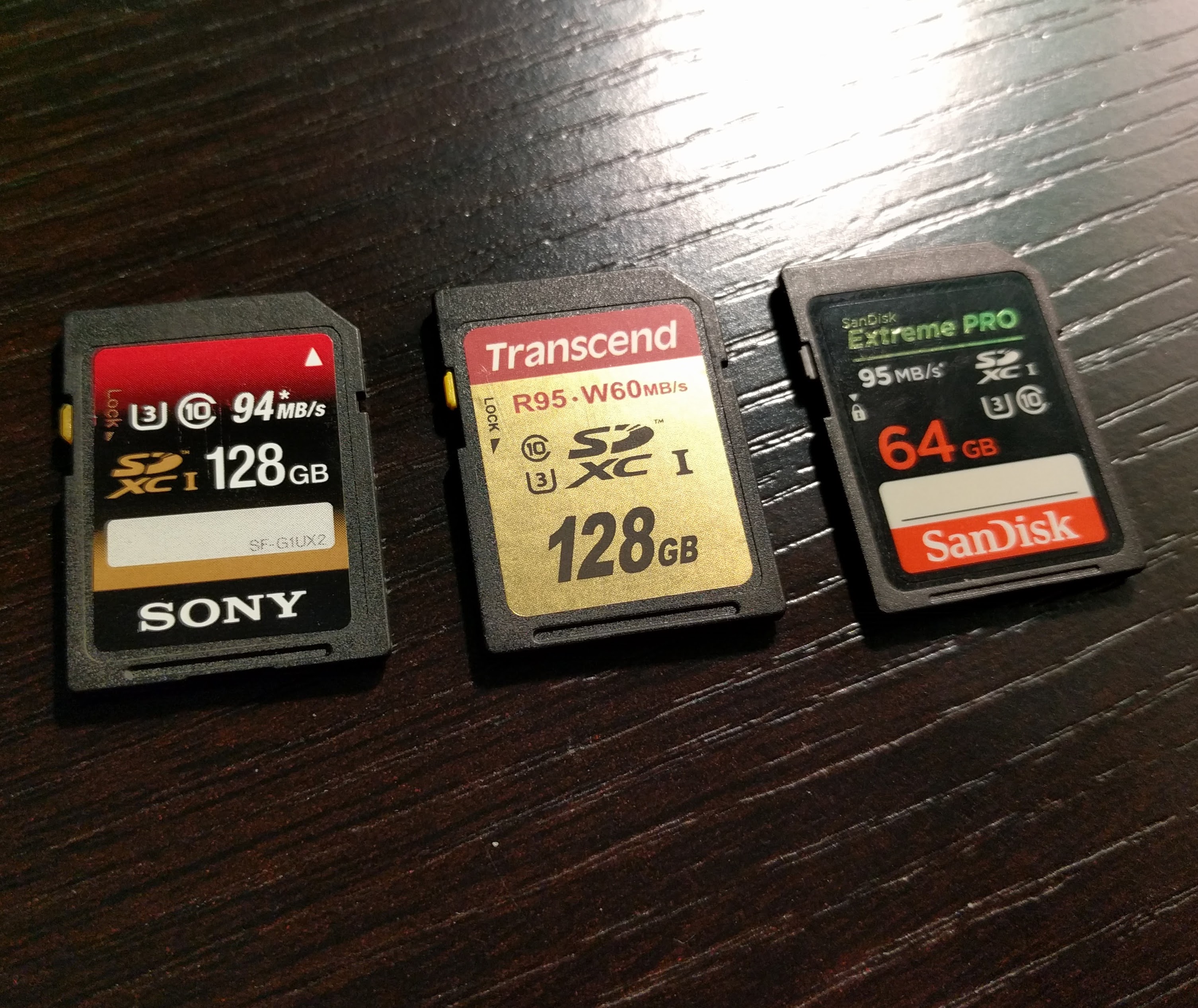

MMC cards? From 10+ years ago? I've listed the brands/types of the cards in my original post. Here are pictures too. They're current UHS-I SD cards that are bought from reputable retailors (so they very likely aren't fake/copies unless B&H got a bad batch).
As you listed, UHS-II isn't even supported so I haven't bought those newer/faster speed SD cards since they aren't even supported. And again my UHS-I cards all work perfectly fine on every other camera I've tried them in.

Then it is time to do a low level format.
Those look to be valid card types.
A UHS-I card should have the SDXC or SDHC logo with a roman numeral "I" after it  (see samples logos here: https://www.sdcard.org/developers/overview/bus_speed/ )
Also, on the back side of the card, a UHS-I card will just have one row of gold contacts on the leading edge.  A UHS-II or III card would have a 2nd row of contacts (photos are at the above SD-card standard website).
I would do a low-level format.
