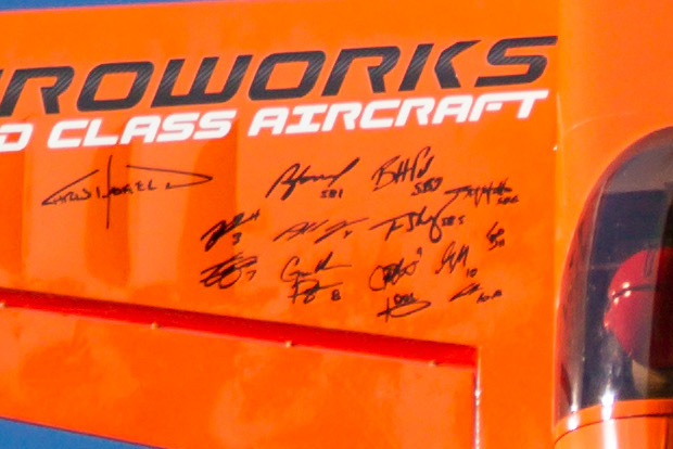

I've shot the Sigma 150-600 C all of last season & it has benched my 100-400 L IS Ver 1 which is quite sharp. I finally got a shot I've been after for the last 2 seasons because for once I decided to use the right shutter speed because I really wasn't after prop blur. I have come very close at getting this result at 1/500 a few times but I think this confirms that the Sigma is sharp enough for most hand holders. Wing span is 88 inches & it's flying right to left doing rolls, I've turned it for the crop. (note slight prop blur even at this setting so likely at full power). First the full frame then a crop to the autographs of the Snowbird pilots 3 years ago & ISS Commander Chris Hadfield. Shot hand held with a 1D mark 4, Sigma 150-600 C @468 mm, f 6.3, 1/2000. At the end of the season I started shooting that lens on my 7D2 with excellent results & I plan on using it together next year along with the Canon 28-300 L IS on the 1D4.
