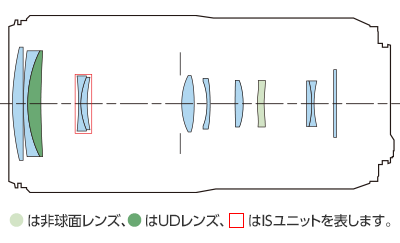

Is it normal that my canon rf 100-400mm lens moves inside? I wanna say its the barrel inside that moves when i shake the lens side to side a little bit. Never paid attention to it until i realized it moved. I don’t know if its because its a longer lens because my 35mm and my 18-45mm kit lens doesn’t do that.

Greetings,
This sounds normal. Its the lens IS. If the lens has not been dropped, it should be nothing to worry about.
05-03-2023 01:11 AM
In the image, you see the IS system in the red area. Most RF lenses have IS in this section. ( 70-200mm f/2.8 -f/4, 100-500mm) You can see this part move when the lens is shaken. This is a normal situation.
