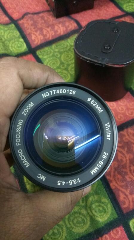

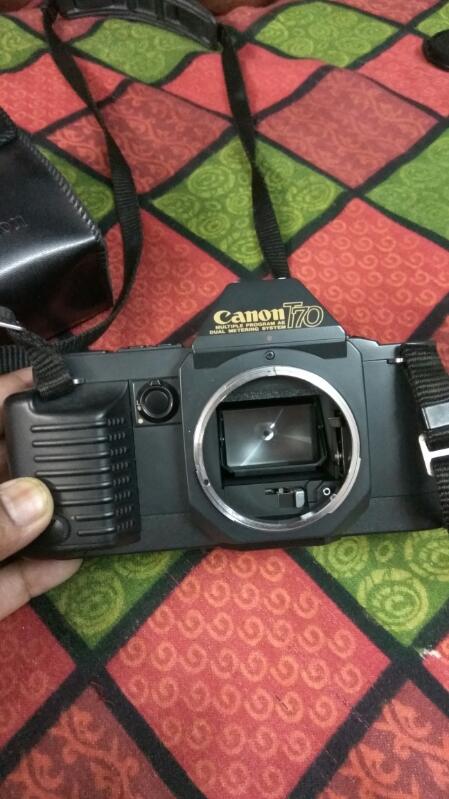

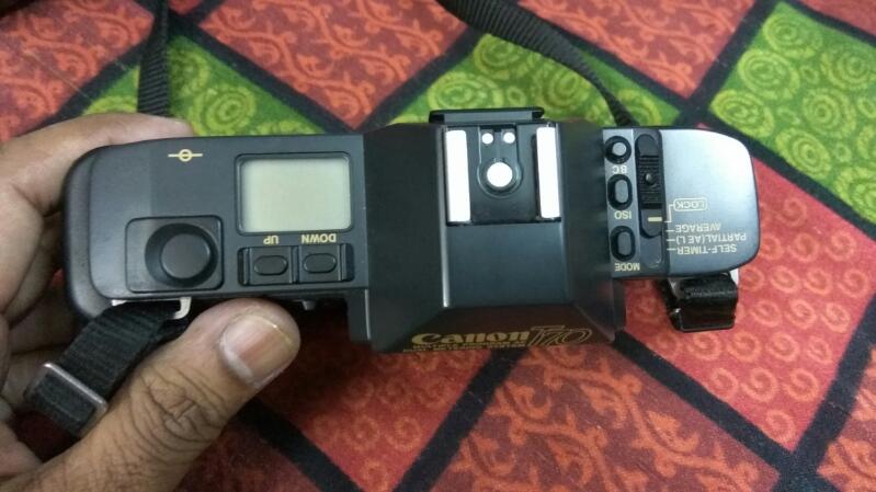

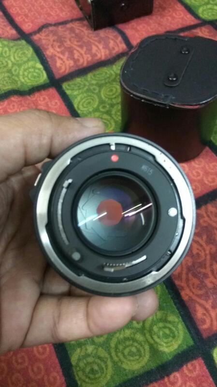

Recently got the Vivitar FD lenses of canon T70 (of year 1984 ) and wants to use them with new technology DSLR's so looking for mounts for them.
Please help/share links of mounts which can be used them OR if they can be used any of new Canon directly.

He's right. It is not worth the time or the cost. Those old lenses will give you disappointing results. Modern "digital" lenses are an entire order of magnitude sharper than the old "film" lenses. Manufacturing today is far more precise.
Another major difference between "film" and "digital" lenses are the anti-reflective coatings that are used in digital lenses. Unlike film, image sensor assemblies can reflect light back up into the lens. This can cause "fogging" and other types of light distortion.

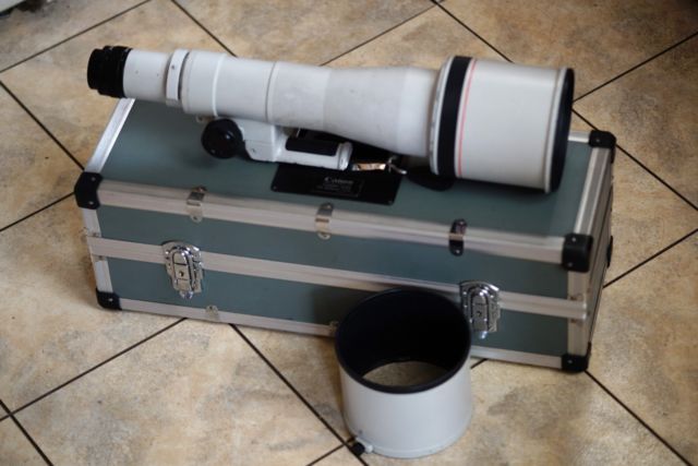

Both above posts are spot on. It isn't worth a second spent on them. Let alone any money. Plus you have picked a particularly poor lens to boot.
However, it can be justified to do this on certain very limited selection of FD lenses but certainly not the one you want to. The FD 800mm f5.6 for instance.

You may want to research Ebay for Ed Mikka adapters.
His adapters are for Canon FD lens. You modify the back of the lens and replace the FD mount with EF mount adapter.
They were selling for about $75.00 each.
You can visit Youtube on how easy it is to change mounts.
Most Important, there is no cheap piece of glass used because Ed Mikka has made his adapter the exact distance necessary for focusing the entire lens design.
