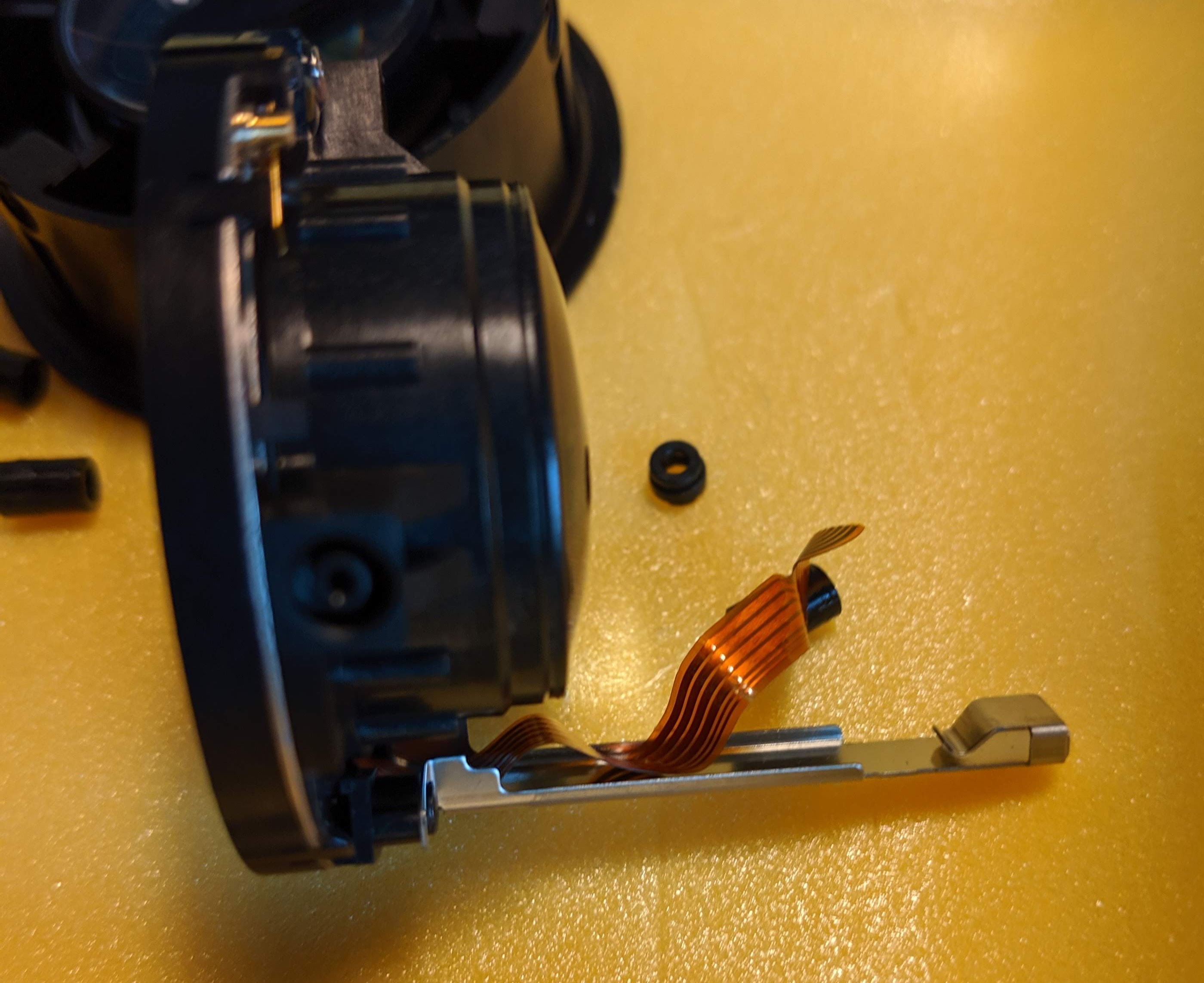

09-30-2019 09:40 AM
Yesterday I started fixing my lens and when I took everything apart I found that flex cable that goes to diaphragm is damaded. I ordered new cable for just $6 and will try to fix my lens. Problem looks like in holder of this flex cable and at some condition cable starts touching lens's body and when you zoom in/out it wears away. Please see attached picture.
