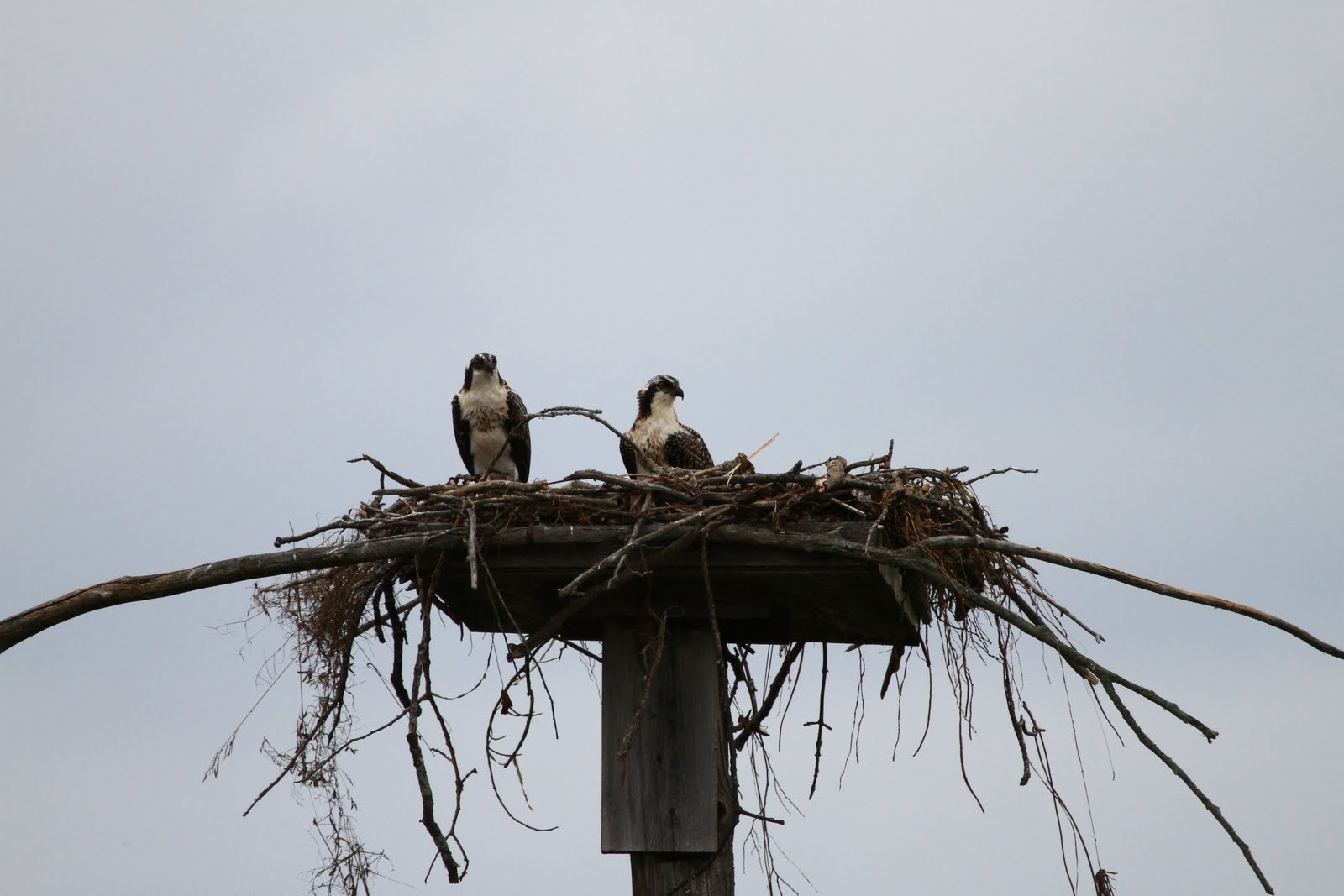

This shot sounds a bit like what you are trying to get height & distance wise but it was shot at dusk so some detail is a bit poor. 7D & 100-400 L at 400 mm ISO 1600 (this is the full frame)
"A skill is developed through constant practice with a passion to improve, not bought."
Thank you again. Yes that is pretty much exactly what I am tryin gto shoot. I have many (more than you'd care to see) on a flicker site http://www.flickr.com/photos/carolynmue/sets/72157632883096221/      maybe you can just skim over them.. I also have some others on this canon site under my account and my photos ? can send you that link later if you are not able to reach it .  which of the lenses you mention do you feel is the best - are they all EF lenses ?  Another question do you know if I could use a doubler with the lens I have now?  (EF S 55-250) on the Rebel T2i?   I really appreciate your help . thank you so much.
