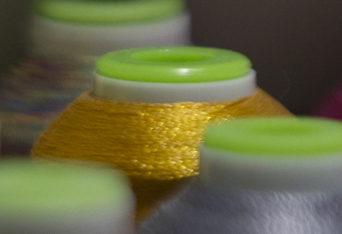

The image of the nest, looking closely, you can see the image is actually very sharp, but there appears to be the effect of petroluem jelly being smeared across the front element. It's very obnoxious. This has always been my dream lens. 😕
The image of the thread right below should show the stygmatism I was referring to. That's at the sharpest possible focus. Going in either direction on the focus ring from here will either result in the highlights becoming bokeh balls or just shifts the "focus" back further.
I would like to make sure everybody knows that this is in now way a back or front focus problem and no amount of MFA will fix this. It's not a camera issue as I've tested it with almost a dozen different cameras at this point. One thing I've noticed with both this lens and the first one I got was the front bit of the barrel is a bit loose, but that pretty much does nothing to the image. And searching all over the internet shows that it is pretty common, I've noticed other people post about this here and in other forums and the answers are never found, but I their description is similar to my issue, but poorly described. I followed up with a couple of different people on another site and their problems were never fully solved, they just either returned the lens, sold it was broken, or sent it in and got it fixed.

In the thread photo I expect you are at or close to the Minimum Focus Distance of the lens.
In the nest photos, there are just out of focus branches in the foreground.
I see nothing that looks out of the ordinary. Remember with a long wide aperture lens you have a very shallow depth of field, objects in front of and behind the plane of focus will be blurry.

Something clearly doesn't look right, but there are still two potentially important data items that I haven't managed to extract from the verbiage:
a) What camera is being used?
b) How much magnification has been applied to what we're seeing?
In particular, at least something in the bird's nest picture should be sharper than it is, UNLESS we're looking at a very small portion of the original image.
