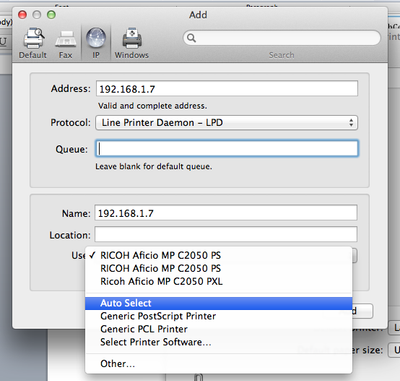

This is just an example, but you should be able to select the correct driver on the printer's properties:
Not from Ventura, But looks similar
After this, does the printer show Ready with Green dot or Red with Offline?
