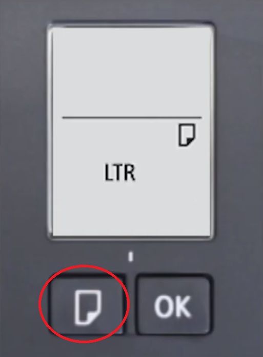

What size paper are you attempting to print with? If you are using letter (8.5" x 11") sized paper, please repeatedly press the Paper button on your PIXMA TS3122 until LTR appears on the lower portion of the printer's display, as seen below. I've circled the Paper button in the image below. Keep repeatedly press that button until LTR appears as in the image below. Once set, please attempt to print.
