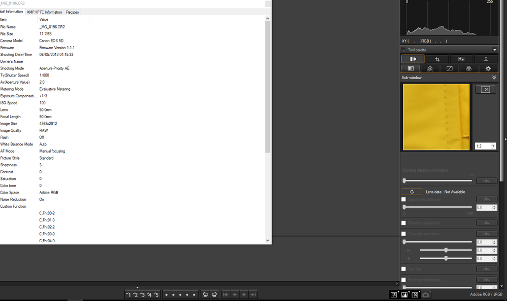

I have cycled through a few editors the past few years and come back to DPP4. While software like Lightroom and Darktable can all find the lens im using, DPP4 says Lens Data: Not Available. I have installed the lens data for the lenses in question (EF 24-105 F3.5-5.6 IS STM, EF 50mm f1.4 USM, EF 70-200 F4L USM) and this has not resolved the issue.
Is there any way i can select which lens is used manually?

To my knowledge.CRW file type (5D mkI) are not supported in DPP4. You need to use DPP3 for the 5D mkI.
Otherwise you'll need to use products like DxO Photolab, Darktable, etc for editing. These products will also provide third party lens support if you go that route.

Also, if the lens information can be downloaded for exactly the same lens, then I would expect Digital Lens Optimizer to work. A camera that old does not read the data needed for DLO from the lens and add it to the raw file.
06-20-2026 01:48 PM
Didn't work for me. 5D + 50/1.4 USM.
