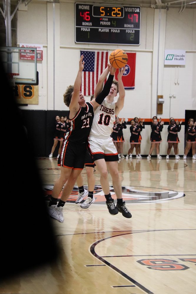

Why would I start having black rectangle strips on my photos? I’m using a Canon Rebel T7i and this just started while I was taking pictures at a basketball game. I have changed lens and it didn’t help.

Here’s some examples. I have already deleted most of them but if you would like to see more I can take some. These aren’t the worst ones. IMG_9889.jpegIMG_0057.jpegIMG_9905.jpegIMG_0085.jpeg
Definitely looks like a failing shutter.  Contact Canon to get an estimate for a repair.
