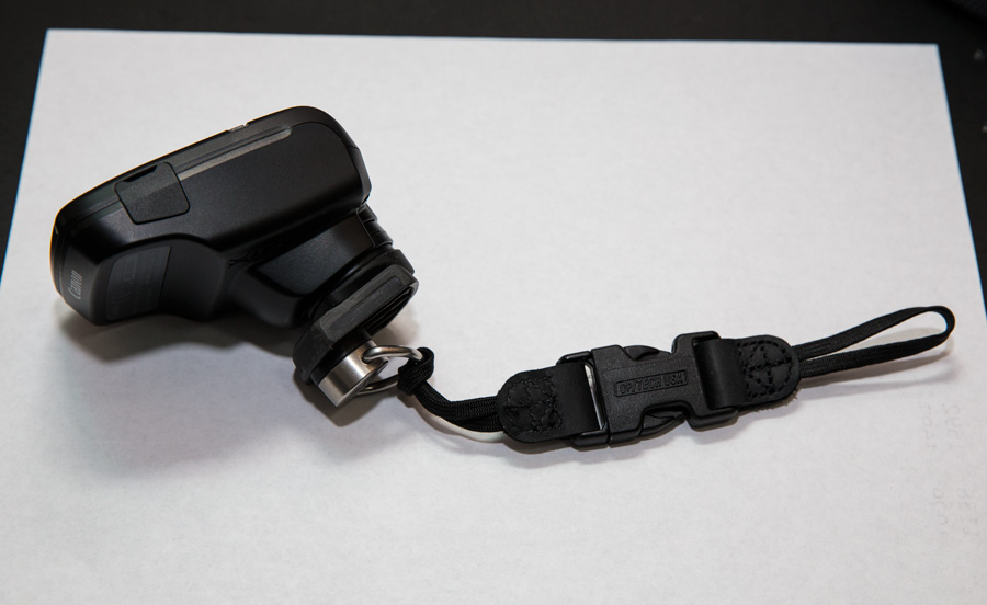

I cut up an old mini stand, attached a spare Black Rapid connector and clip it to my belt. I hold my Sekonic LM in my hand. When done I connect it to the hotshoe. Only con is there is no AF focsus assist.
