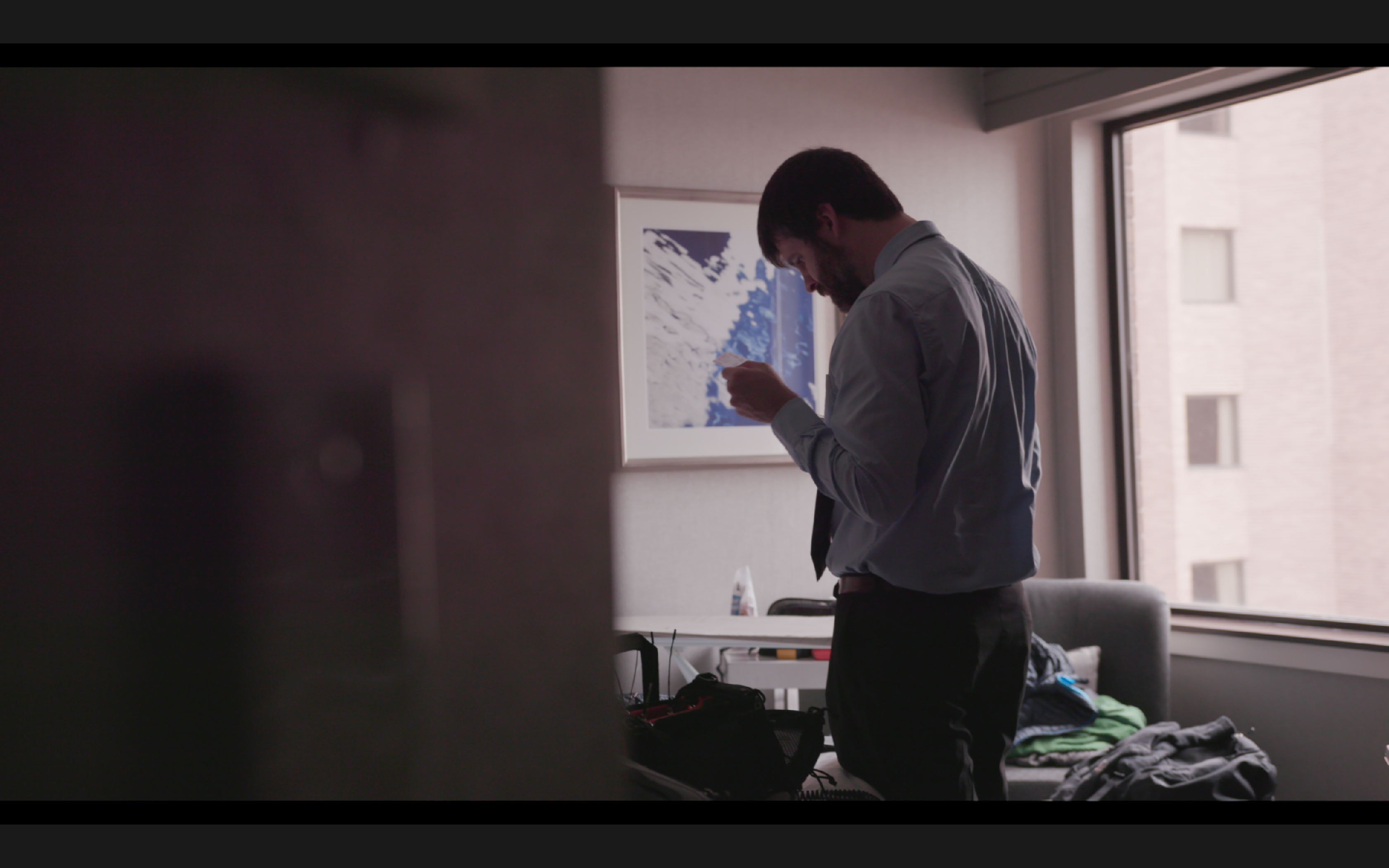

I'm sure this has been discussed before but has anyone experienced this awful purple glitch with the C300 Mk II? (footage stills below)
I'm shooting a feature doc right now and it's constantly giving me trouble when shooting in backlight. Even rented another body and we're still having the same issue. I took it to canon and they said it was just normal and to avoid shooting in backlight. I do not believe this is acceptable for a camera. It's hideous and completely baked into the footage even in the log. Looking for any workarounds or advice before considering a different camera for the remainder of our shoot.
Screenshot 2017-11-29 10.34.41.png24131767_10214863918335064_8824983347233337615_o.jpg

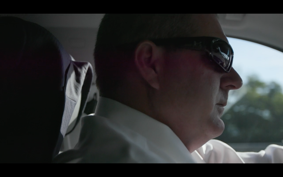

Here's a frame from a shoot I just did as well.  See the stripe across the talent's chest.  Shot in CLog3, Cine Gamut, 1080p 10 bit 4:2:2.  Latest firmware.

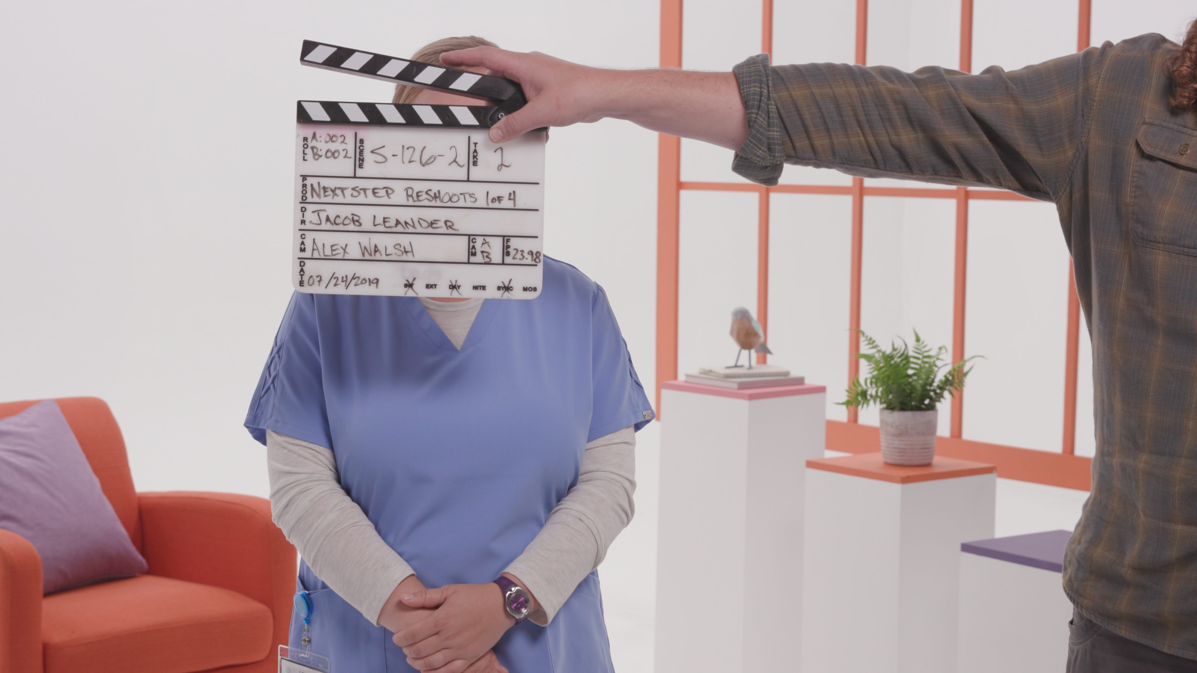

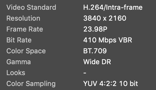

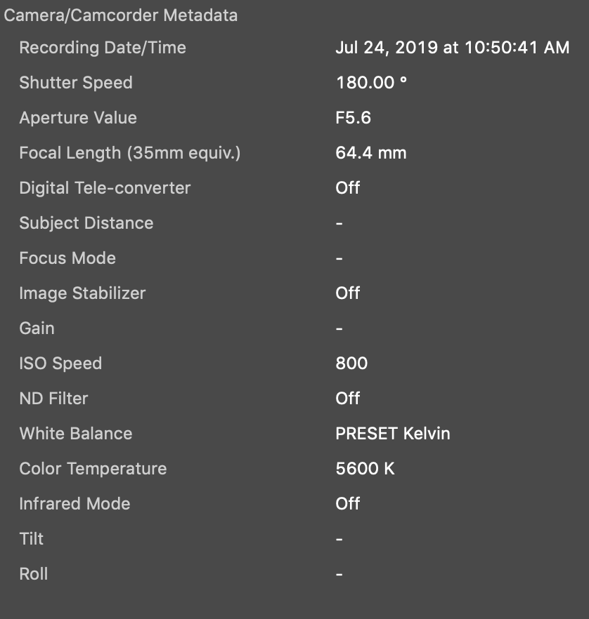

I've attached a frame grab of the footage, and screen grabs of the camera settings. Pretty simple stuff here. The subject is being lit by daylight fixtures (ARRI Skypanel)A002C009_19072407_CANON_10500008.JPGScreen Shot 2019-07-24 at 12.59.01 PM.pngScreen Shot 2019-07-24 at 12.59.13 PM.pngScreen Shot 2019-07-24 at 12.59.24 PM.png
Apologies for the long delay, never saw the reply here.  Not sure if the purple was visible on camera or on playback from the camera.  Didn't notice it until post (in Premiere and Resolve).
Yes, I'd be willing to try and recreate it while shooting in different modes.  Do you have specific parameters you'd like me to use?  Does this not appear on all C300mk2 cameras?  Are you able to recreate it on your end as well?

I get this glitch pretty often. It's most common during backlit situations, especially when talent is driving a car and operator is shooting from passenger seat. I had a very bad example of it happen last night shooting during sunset with talent against the last of the light in the sky. Two very pronounced purple bands across their body.
For this project im shooting 1920x1080 YCC 422 10bit, CLog2 : Cinema Gamut.
