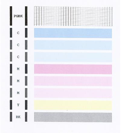

Did the nozzle check that you printed match the example below:

09-10-2019 02:47 PM
Yes, the nozzle test looked like that. It came out clear, and all the colors were clear and vibrant without any purple where the black should be.
The ink cartridges are in this order from left to right: Magenta (251), Black (251), Yellow (251), Black (250, larger tank), Cyan (251)
They're the same cartridges I had in the printer when it was working fine. Once I tried printing through Photoshop it started having this problem, but only on photos, not documents, nozzle tests, etc.

If the all of the colors are printing on the nozzle check, the printer would appear to be working fine. The issue may be related to either the image that you are printing or your software. Try printing a different image from different software to narrow down the cause of the issue.
