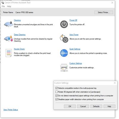

As for your second question, it appears than the PRO 300 menu is a bit different. Here is a screen shot of my settings. And maybe I got it wrong when I assumed that a check means disable the width mismatch detection.
