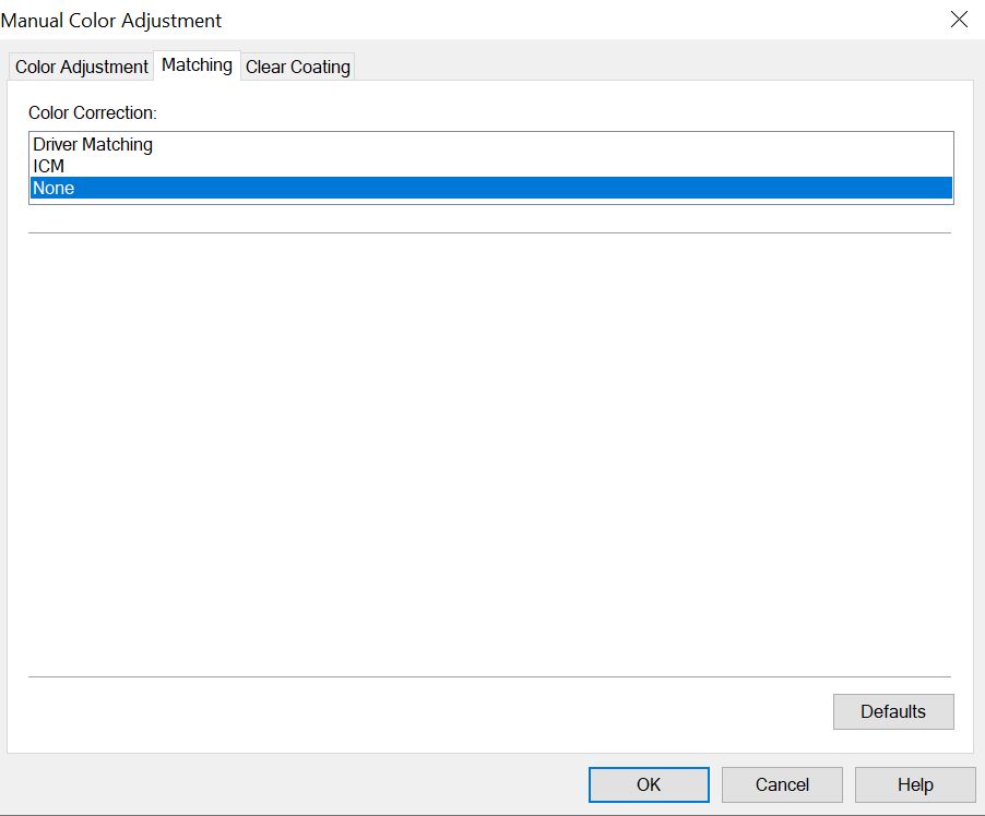

Hi Andreas. Looks like you established that your printer is functioning properly.
On your W10 computer, what monitor are you using? Does it have preset settings? My monitor has a number of settings I can select - sRGB, AdobeRGB, D50, D65 and Calibration. When I use the xRite calibrator I select the Calibration option. If I select sRGB then the monitor ignores my calibration and using the built-in sRGB profile. Does your monitor allow for this?
My monitor also came with an ICC profile file. It is a factory profile, not based on the actual profiling of my display, so it would be close but probably not 100% accurate.
On your computer, go to the Control Panel and in the search box type "colo". You should get a choice for Color Management. Select that.
Check the Use My Settings option. This will ensure that the display is using your profile. In my case the profile I created is #1 and the factory profile is #2. If you see a factory profile for your monitor try using that to minimize variables. Also check the monitor manual to see how to reset to factory settings.
The Mac printer driver automatically configures the driver to avoid double profiling. You need to do that manually on a Windows machine.
Here are the steps to do that.
My other suggestion would be to use Canon paper and the factory Canon ICC profiles for the paper to minimize variables.
