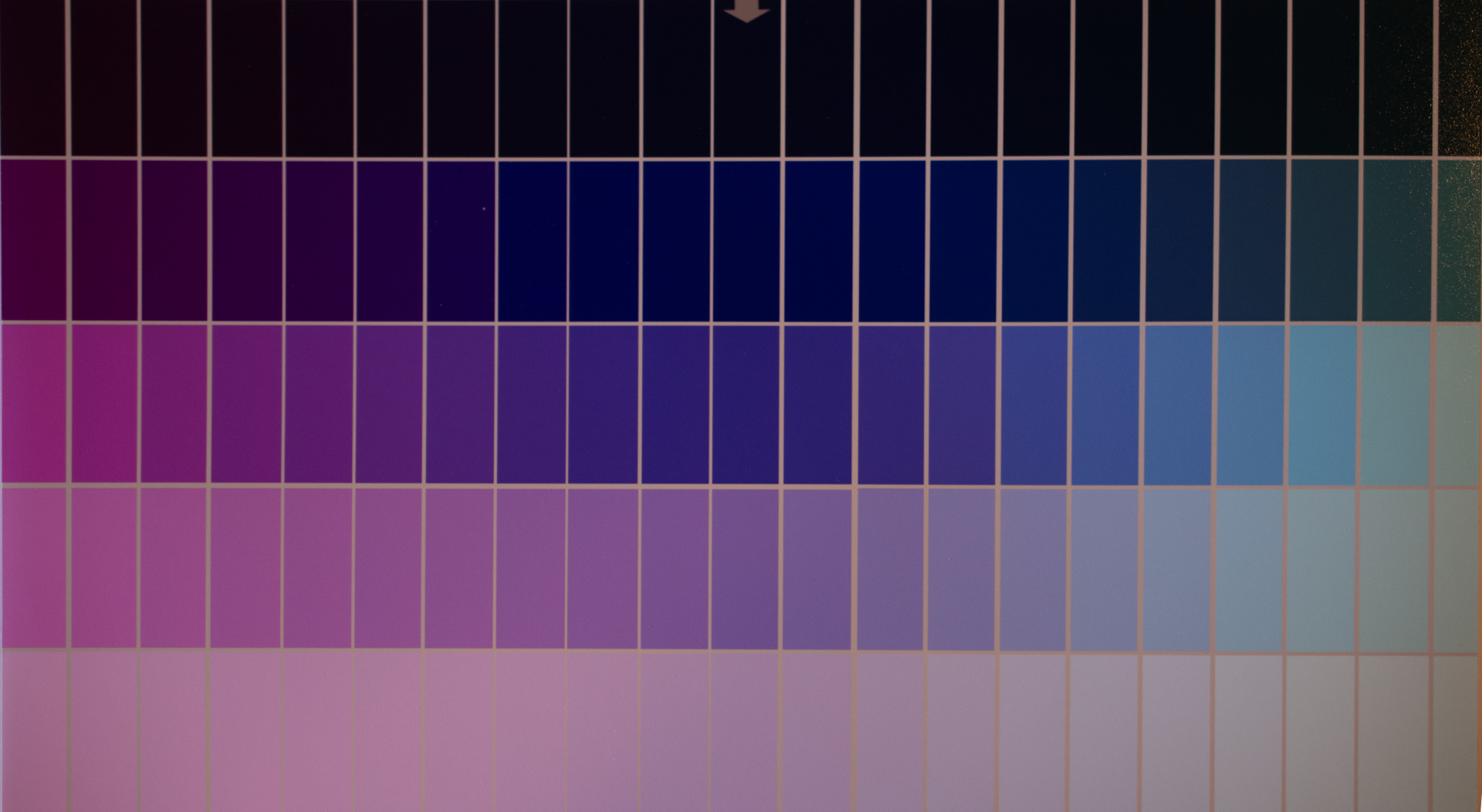

My brand new Canon PRO-100 is printing all blues as purple.
Reference blue color spectrum (screen shot of file I built in Photoshop):

How this prints out:
Note in particular, the mid-image blue boxes that are reasonably true blue in the screen shot, but print out as quite purple.

E.g., The reference scan above is my creation.  I know the RGB values of every square.  Even if my monitor has some color reproduction problems, the source Photoshop file prints from known RGB values.  The mid square of the grid is 0-0-255.  Yet it prints more nearly as 64-0-128 ... that's a relative increase in red of 50%.

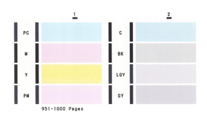

Printing the Nozzle Check pattern does not burn through a lot of ink.  Please print a Nozzle Check pattern to make sure that your PIXMA PRO-100 is printing correctly:
 1.  Turn your PIXMA PRO-100 on and make sure paper is loaded into the sheet feeder, and not the Front Tray.
 2.  On your PIXMA PRO-100, press and hold the RESUME button until the printer light blinks white twice. When you release the button, the Nozzle Check pattern will be printed.
 3.  After the Nozzle Check pattern is printed, compare your printout to the example that has been attached to the bottom of this message.
Does your PIXMA PRO-100 print this pattern correctly?

I ran a nozzle check, and the two cyan colors (and every other color) printed fine.
I also took both cyan ink tanks to verify ink is flowing (by touching the dispensing point gently to a paper towel): no probelms, ink comes out.  And per a Youtube instructional, I verified the sponge side of the cyan ink tanks look soaked on the lower half.
