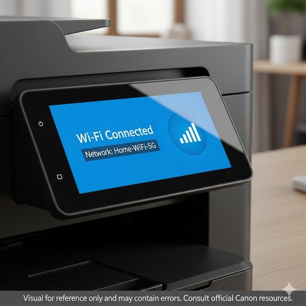

The Solution: Infrastructure Mode We need to ensure the printer is connected to your Router, and then all your devices will talk to it through the router simultaneously.
Step 1: Get the Printer on the Network (Do this ONCE)
On the TR8620 touch screen, tap the Gear icon (Settings).
Go to Device Settings > LAN settings > Wi-Fi > Wi-Fi setup.
Choose Manual connect (this is often easiest).
Select your home Router's Wi-Fi name and enter the password.
Once the screen confirms it is "Connected," you are done with the printer panel. Do not go back to this menu for the next devices.
