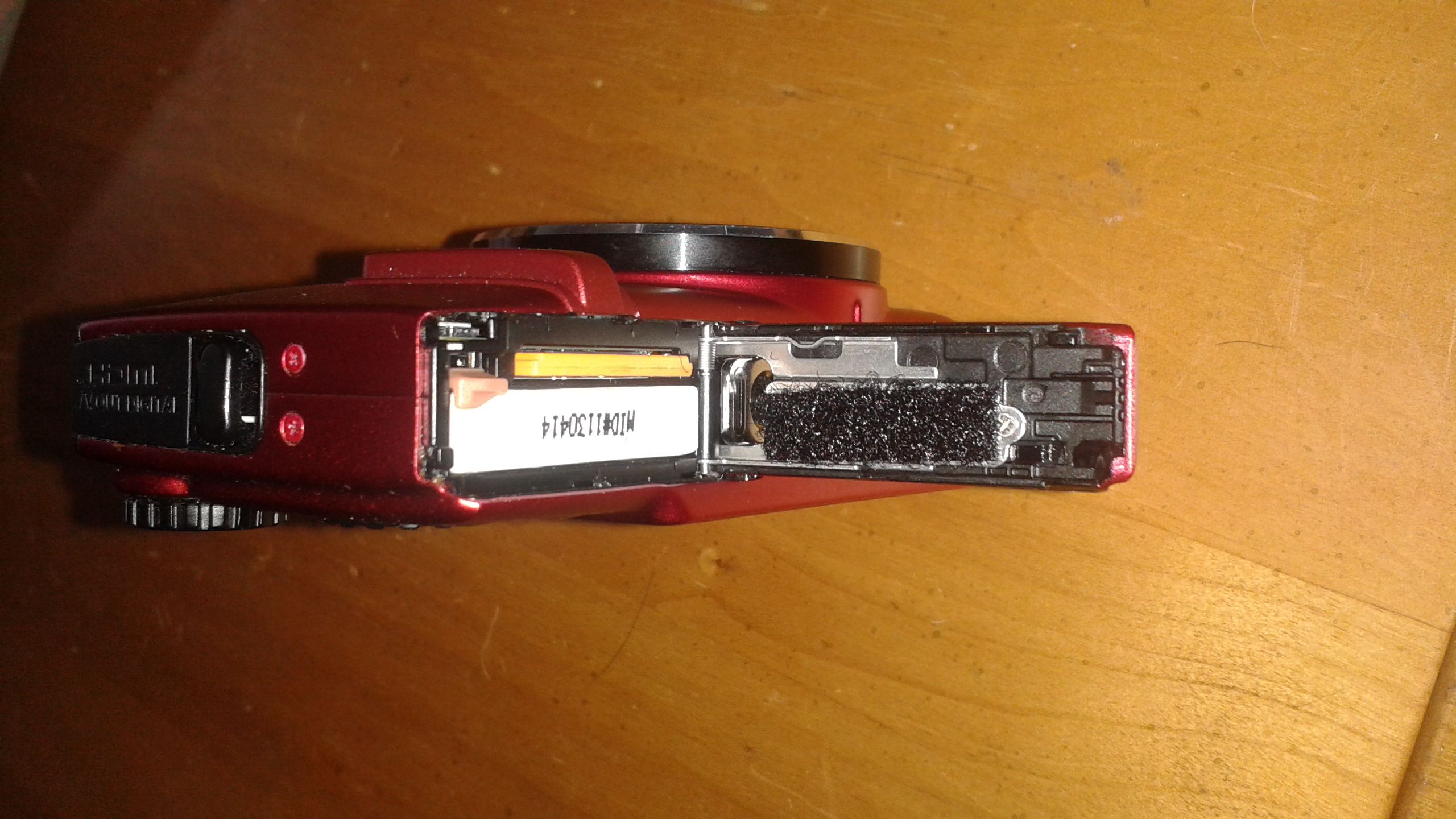

10-18-2014 09:16 AM
I have solved the battery issue.
The trouble is that the battery contacts and the camera power contacts don't stay together. The battery is just a bit too small for the space, and the tab that holds it in place is on the wrong side of the battery.
My solution is to add a bit of the fuzzy part of velcro to the inside of the battery door. It holds the battery contacts securely together, and the problem goes away.
If you happen to use the ACK-DC40 AC adapter kit, you'll need to punch a small hole in the Velcro to allow the power plug to get through to the adapter, but if you don't use one, just stick the Velcro strip on the inside of the battery door, and your problem is solved.
