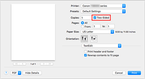

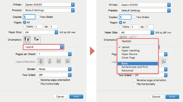

Two-sided printing for this model is handled computer-side. In the system print window, ensure Two-sided printing is unchecked beside the number of copies to be printed. In the case that the two-sided printing box doesn't show up in the upper part of the system print window, then ensure the drop-down for it on the Layout submenu is set to Off.
