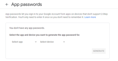

For the password, I would enable 2 factor for the account. You should be using this for enhanced security anyway. Create an app password and use it in the password field.
Sign in with App Passwords - Google Account Help
